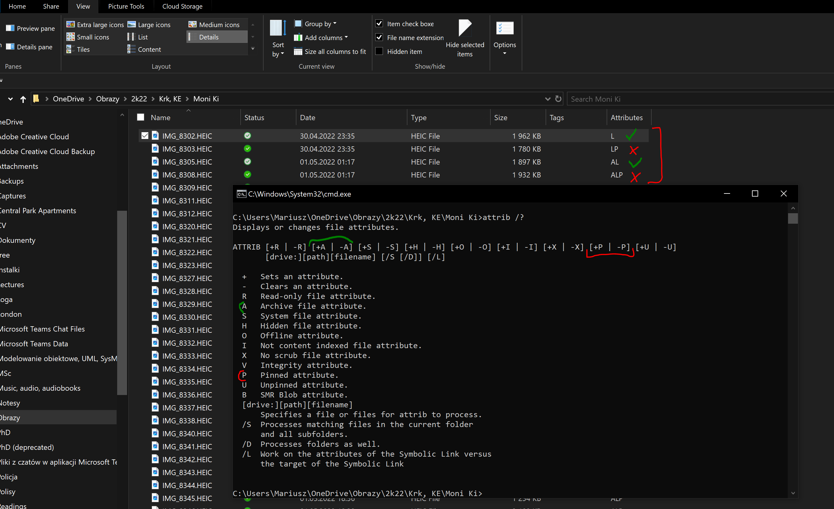

    @Geoff Welch 's comment helped me solve the issue, thank you so much for this! I'd like to follow up as I did some additional analysis.
    What's really preventing one from copying OneDrive files to an external network storage is the P (pinned) attribute assigned automatically by the OneDrive's client on selecting the Always keep on this device option. According to some resources, it is supposed to prevent a file from being removed when there's low space left on a hard drive. Removing the A (archive-ready) attribute is purely optional here. I was able to copy files with both L and AL attributes, but not with P.
    Capture
    Hence, in order to copy files synced manually with OneDrive, open the command prompt and enter:
    attrib -p Path\To\Your\Filename
    to remove the attribute from a single file or
    attrib -p Path\To\Your\Files\Directory\*.*
    to remove the attributes from all files in a given directory.
