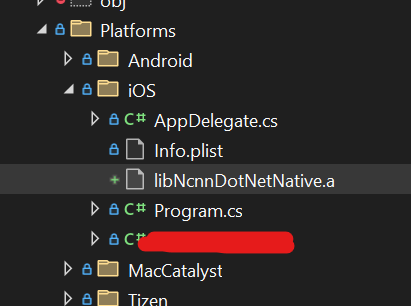

    I have my library in the root of my iOS Platforms directory: /Platforms/iOS/libCLib.iOS.a Important in the iOS Build settings: Linker behaviour for Debug has to be "Don't link" or "Link Framework SDKs Only".

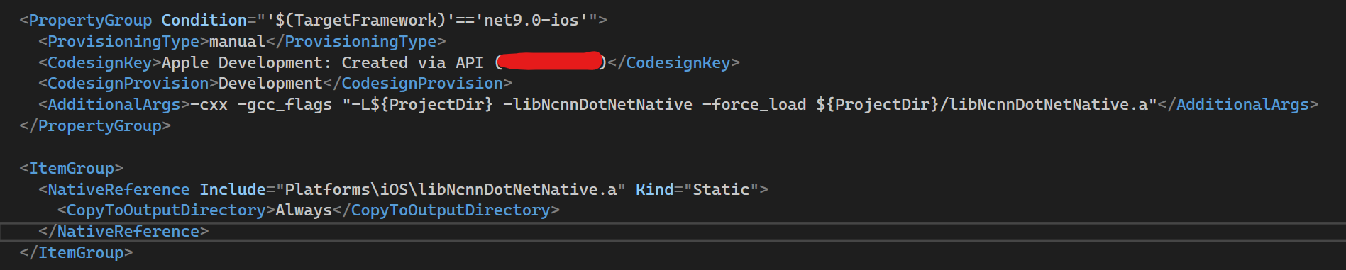

    <PropertyGroup Condition="$([MSBuild]::GetTargetPlatformIdentifier('$(TargetFramework)')) == 'ios'">
        <MtouchLink>Full</MtouchLink>
        <AdditionalArgs>-cxx -gcc_flags "-L${ProjectDir} -lCLib.iOS -force_load ${ProjectDir}/libCLib.iOS.a"</AdditionalArgs>
    </PropertyGroup>
    <ItemGroup>
        <NativeReference Include="Platforms\iOS\libCLib.iOS.a" Kind="Static">
            <CopyToOutputDirectory>Always</CopyToOutputDirectory>
        </NativeReference>
    </ItemGroup>
