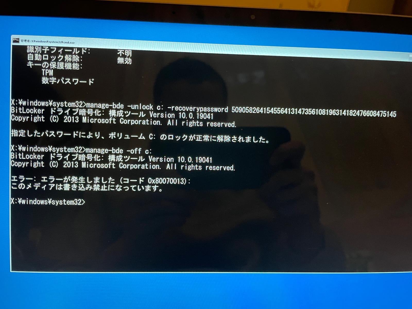

    hello Molly
    Thank you for your support but didn't work either. The progress gave an error.

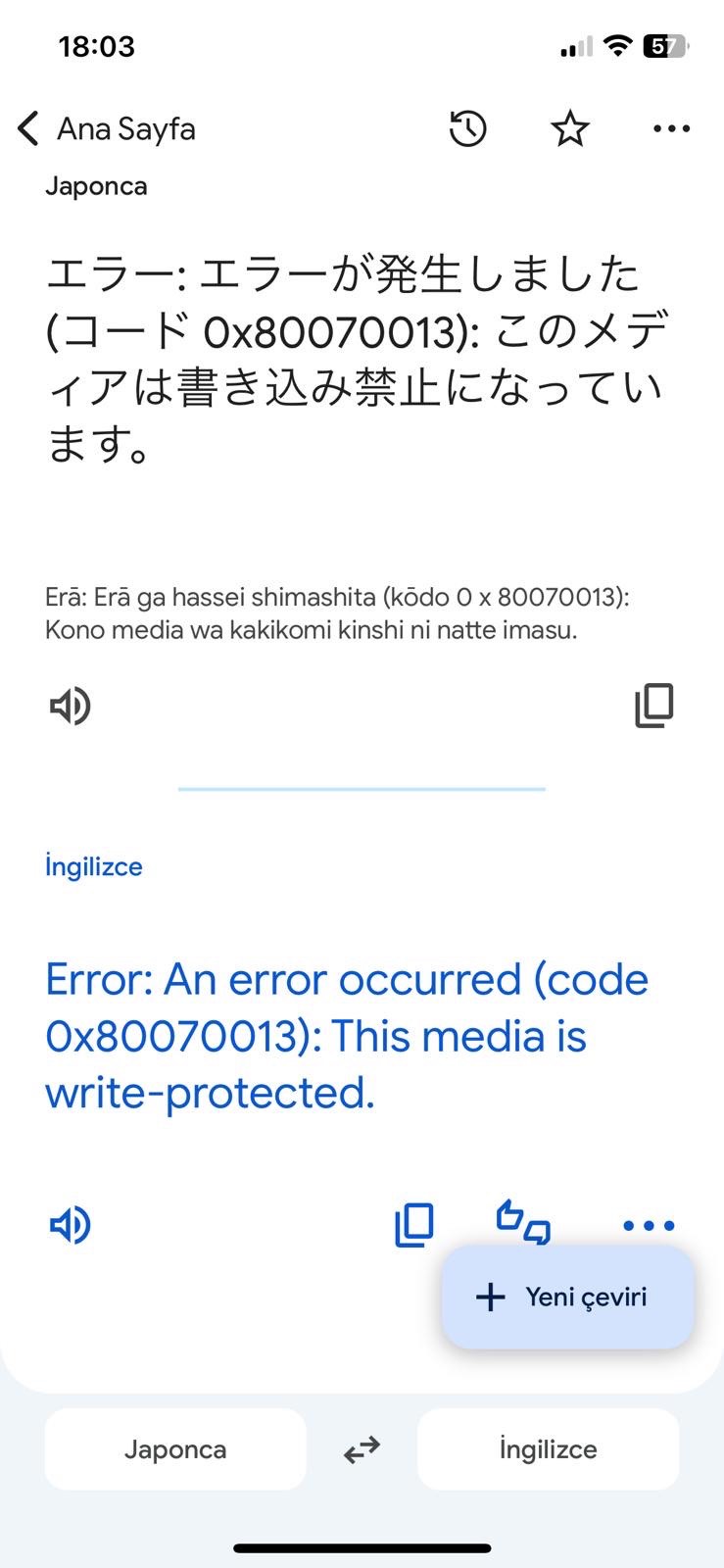

  4. Anonymous
    2025-02-17T00:57:38+00:00
    It sounds like you're encountering a BitLocker error with the code 0x80070013, indicating that the media is write-protected.
    Try disabling/ deleting the BitLocker protectors on the disk:
    manage-bde -protectors -disable c:
    manage-bde -protectors -delete c:
