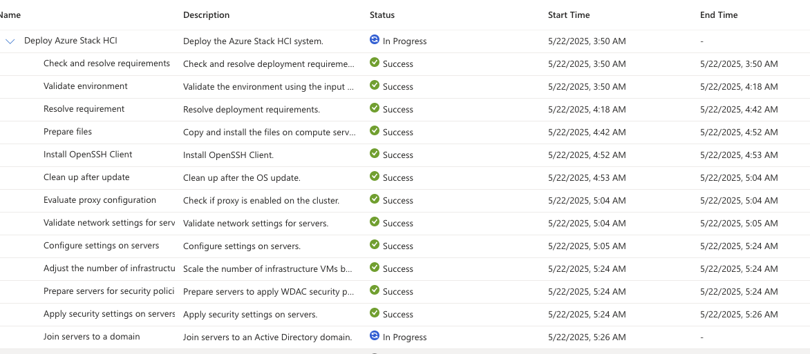

After nearly 100 hours of just awfulness, I finally got to the point where I cleared validation and began the deployment. However, it hung after each of the nodes were adopted into the AD. Now each node is stuck autobooting to deploy and won't let me delete the VMswitches or anything else. Before I start over and reimage each node, is there anyway to reset the nodes to "factory" or at least to state where I can attempt a redeployment? There is literally 0 documentation and since Broadcom ruined the only semi-decent product out there, I'm stuck figuring this out.

2025-05-22T13:53:46.0533333+00:00 I stayed up until 4am, reimaged all the hosts and started completely from scratch. Same behavior, stuck after the nodes are adopted into the AD. Unless someone has an idea better than spending 6 hours to reimage all the hosts and get them in Arc again, I do believe Proxmox is my future.

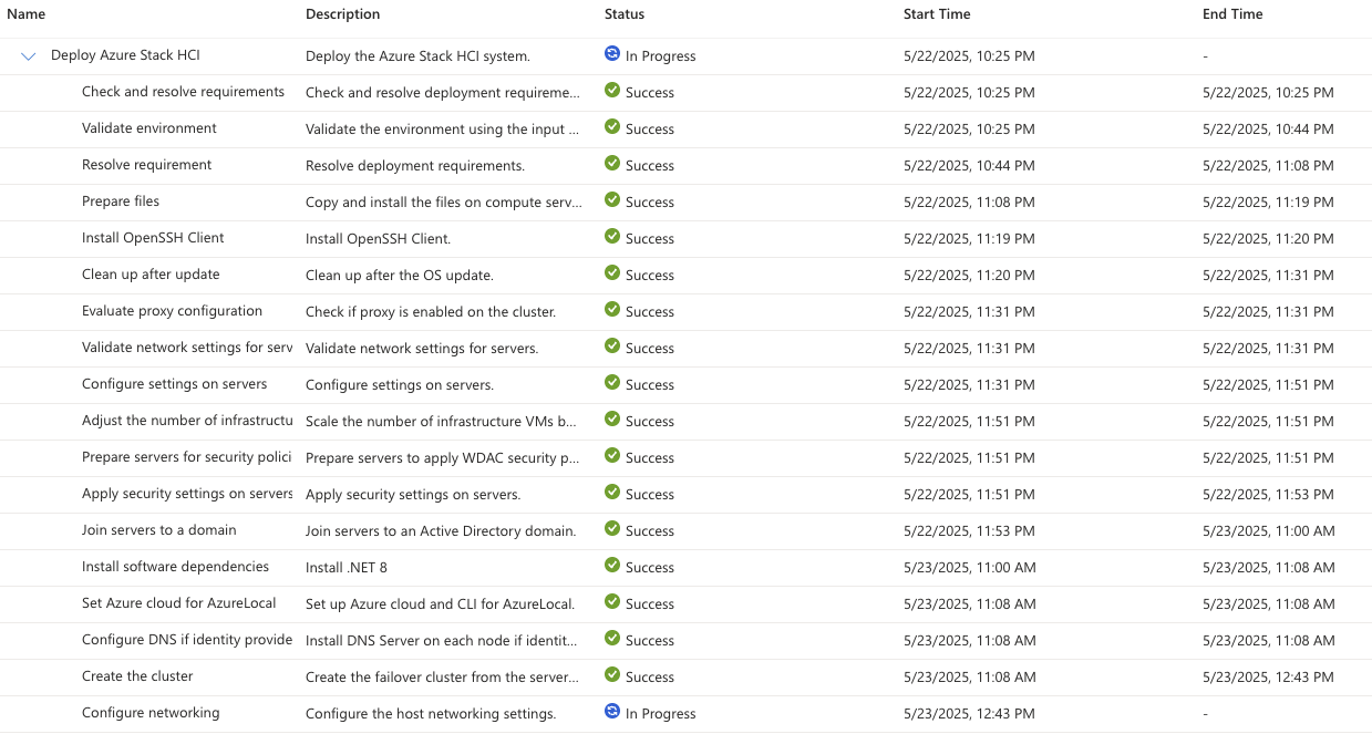

The horror show of this deployment continues into its 27th day. After it hanging on the join domain step for 10 hours, it times out. The "resume deployment" button un-greys. Clicking it and it does in fact resume and join the domain.
After getting to the "create cluster" step and failing. Thank god it just failed with an error message and log file, which is the exception, not the rule with azure local. I had to go into each node and manually disable ipv6 on each nic. Not sure why its enabled, at no point is it mentioned in the guide or in sconfig. Clicking resume deploy, resumes the deployment.
Now I'm hung at "configure networking." No log, no feedback. Just hung. Really inspires confidence that we will have a multi-million dollar setup potentially running on this.
So, question, do I just wait 10 hours again? The click "resume deployment". Is there someone at Microsoft who wants to explain to me why we would spend hundreds of thousands of dollars on this? Is Azure Local even a real thing? Am I stuck in a 27 day long coma?

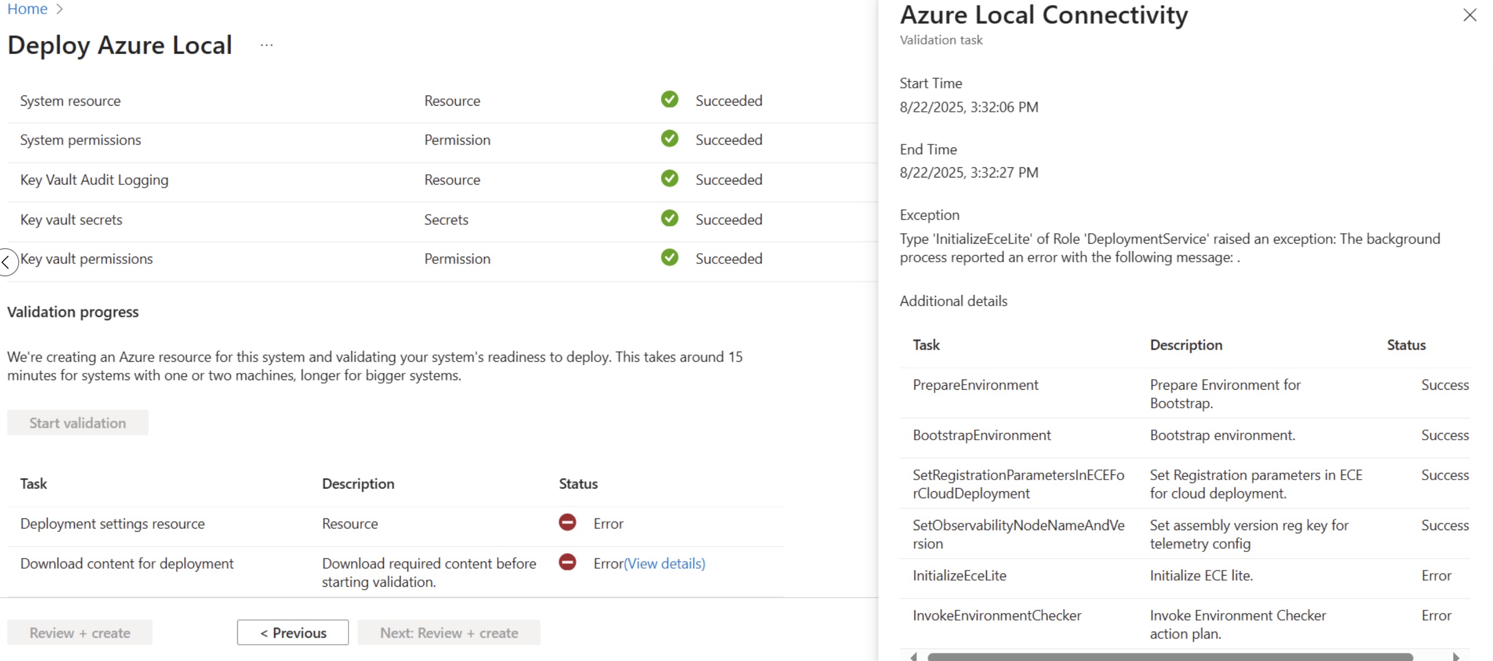

2025-08-22T21:07:15.32+00:00 Hi @Mike Jackman Since you had spent hours to fix the validation, just wanted to check if you ran into the issue that we are having right now with our deployment. I have attached the snapshot. Please see if you can help in here
Mike Jackman • 0 Reputation points
2025-08-23T14:03:01.5533333+00:00 Don't. Seriously, just use regular WSFC or Proxmox. I got the entire cluster setup, it took weeks and the first AKS deployment borked the entire system, with Microsoft telling me to start over AGAIN. It doesn't work. This product is years, if ever, away from being production ready.
