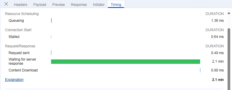

While hosting a https URL on an IIS Server using Microsoft Edge browser in Windows 11 system (Microsoft Windows Version 24H2 OS Build 26100.2314), waiting for server response is more than 2 minutes. For processing the network requests, it takes about 120-140 seconds Win11_DelayIssue.png, because of which the page login is delayed for about 120-140 seconds. Kindly let us know if there is any resolution to fix this delay issue.
Please let us know how to optimize the waiting time taken for server response.

    Thank you for providing the details and the screenshot. From your description, the issue typically indicates a Time to First Byte (TTFB) issue, which often happens during the initial connection or TLS handshake rather than page rendering.
