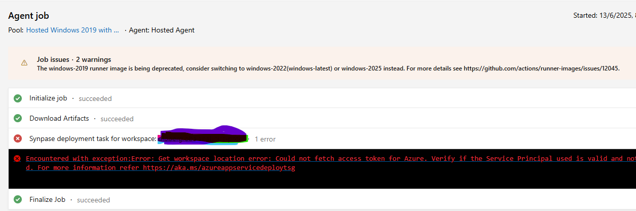

We;re creating a release pipeline for Azure Synapse using
WIF for automatic connection and everything works fine ( Verified Permissions on the SPN) however when running the release pipeline Getting this error .
025-06-13T11:42:41.3876045Z An error occurred during execution: Error: Get workspace location error: Could not fetch access token for Azure. Verify if the Service Principal used is valid and not expired. For more information refer https://aka.ms/azureappservicedeploytsg
2025-06-13T11:42:41.3903578Z ##[error]Encountered with exception:Error: Get workspace location error: Could not fetch access token for Azure. Verify if the Service Principal used is valid and not expired. For more information refer https://aka.ms/azureappservicedeploytsg

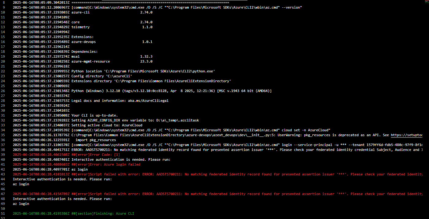

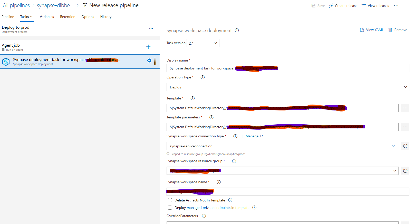

    The root cause of your issue is that the Azure Synapse deployment task does not currently support Workload Identity Federation authentication. Even though your service connection is configured with WIF correctly and the Service Principal has valid federated credentials, the underlying deployment task attempts to retrieve an access token using the legacy ServicePrincipal credential flow, which fails in WIF-based contexts with the error
    To resolve this issue, you should switch from the Synapse GUI task to an AzureCLI@2 task, which fully supports WIF and can deploy Synapse artifacts using Azure PowerShell or REST APIs. In order to replace Synapse task with AzureCLI@2, create a new Azure CLI task in your release pipeline

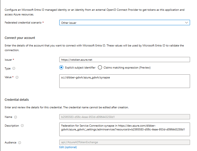

    Just ensure your synapse-serviceconnection is set up with WIF and the Federated Credential in Entra ID has issuer: https://vstoken.azure.net
