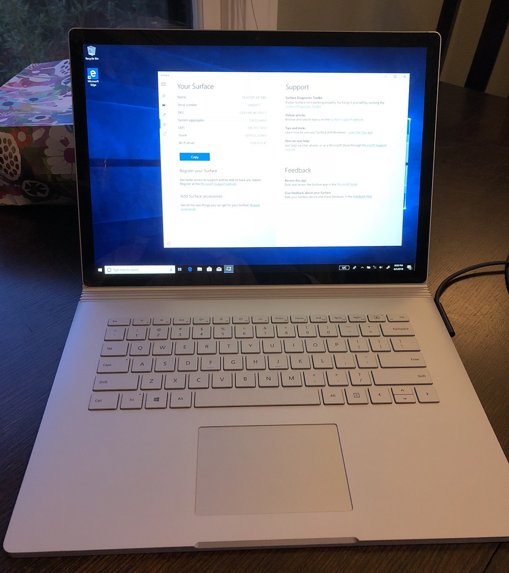

I bought a used Surface Book 2 15 on my local Craigslist. I'm unable to install the Surface Diagnostic Toolkit or the latest firmware as it says it's not a Surface device. I also can't register it the serial number can't be found. Is this a prototype device? Is this a normal SKU (OEMSHP SKU DV1 i7)? It doesn't have the "Prototype Not For Resale" etched on it like other devices seem to have.

    Thank you for reaching out. Let's sort this out. However, to be able to understand the issue better, can you give us more details by answering these following questions:
    • Were there any error messages when you attempt to register your Surface Book 2?
    • Since you mentioned that the device is a prototype, can you send us an image of it so we can have it checked on our end?
    Also, to know the serial number of the Surface, you can check this link for more information.

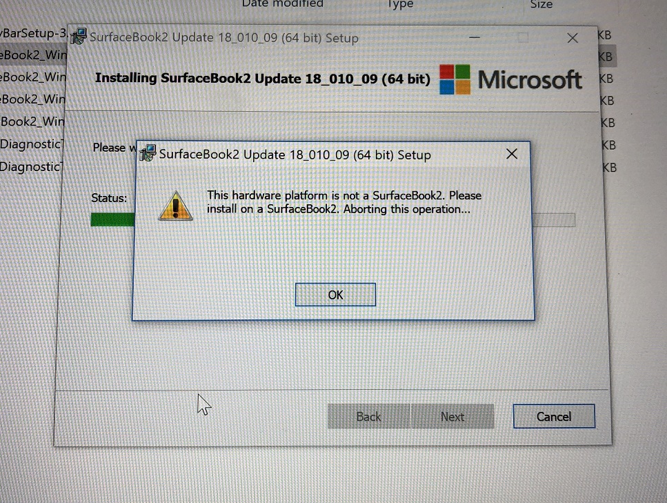

    This is the error I am getting. I've tried for a week now.
    We’re sorry, but something went wrong on our end. Please try again later. (pzg4viXvjEuScxu/.24)
    The serial number in the Surface app matches what's on the bottom of my Surface Book 2. What pictures do you need?

    It's running Windows 10 Pro. Version 1803. OS build 17134.81.
    The problem is the firmware stops and says "This hardware platform is not a SurfaceBook2. Please install on a SurfaceBook2. Aborting this operation...".
    Also, I am unable to register my SurfaceBook2.

    I appreciate the information. Can you try downloading and installing the Surface Book 2 drivers and firmware from this page?
    If you get any errors, please update the post.
