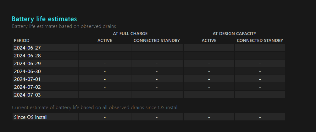

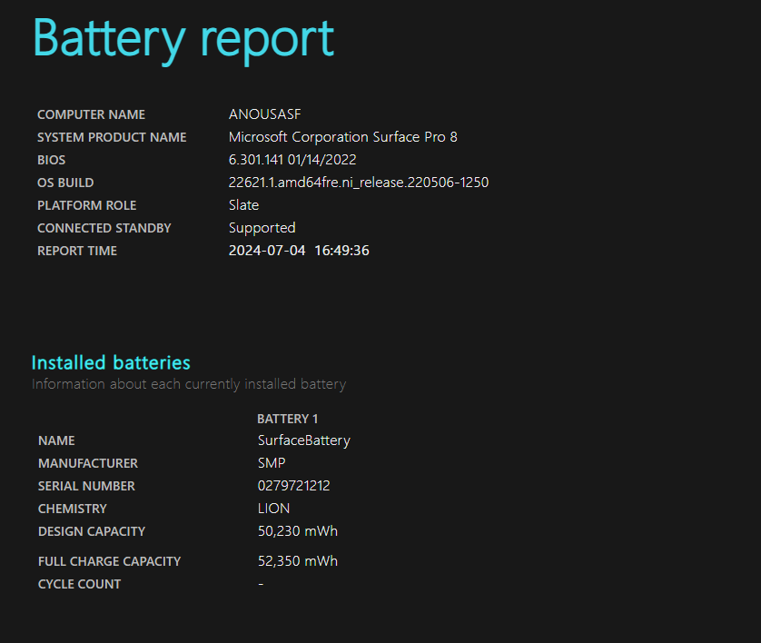

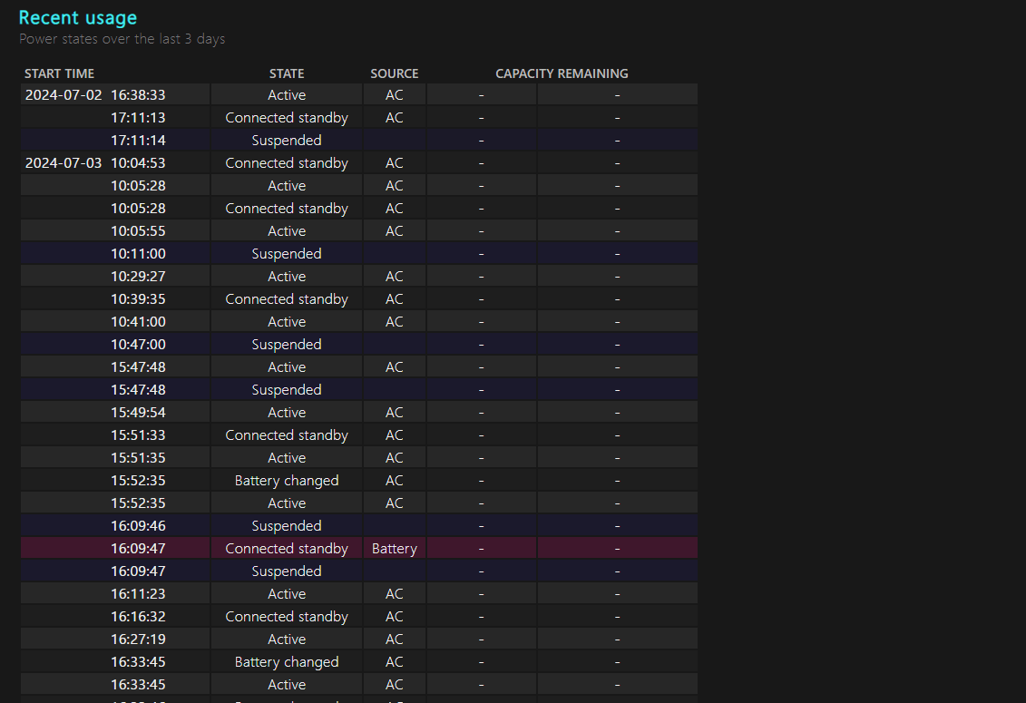

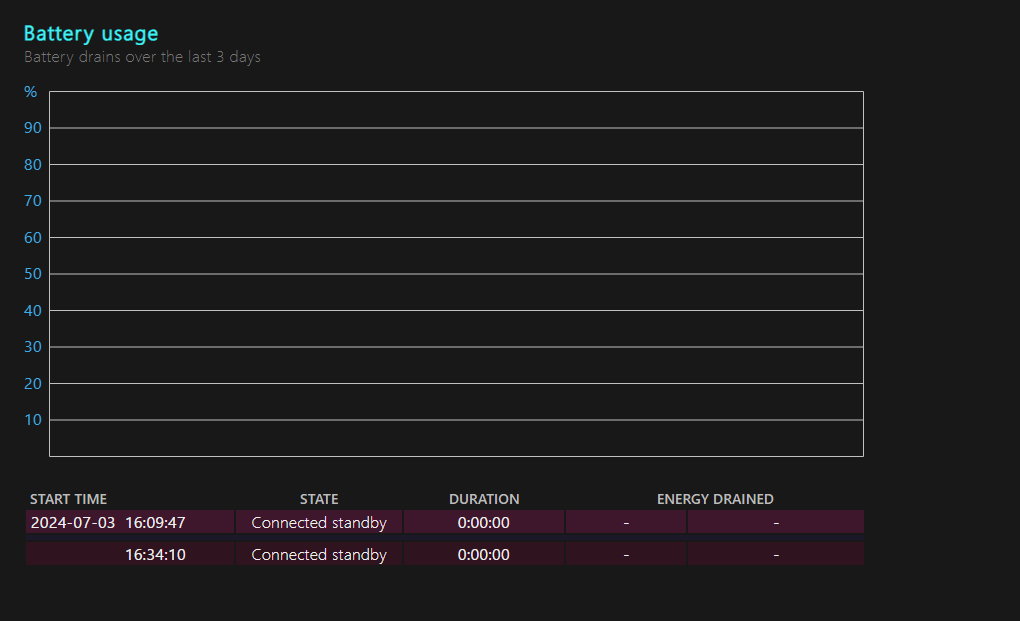

I have a brand new SF Pro 8 with battery problem. I have tried hard reset, update firmware, update Windows, calibrate battery, and still cannot solve the problem. The result of 'powercfg /batterreport' shows 1 battery detected, but in Surface Diagnostic Toolkit said 'No Battery Detected' and not genuine Microsoft battery when trying to authenticate it. Please kindly help.

    Thanks for all the information you shared here, if the Surface diagnostic kit does not correctly identify the battery in the device, then it usually represents a battery failure.

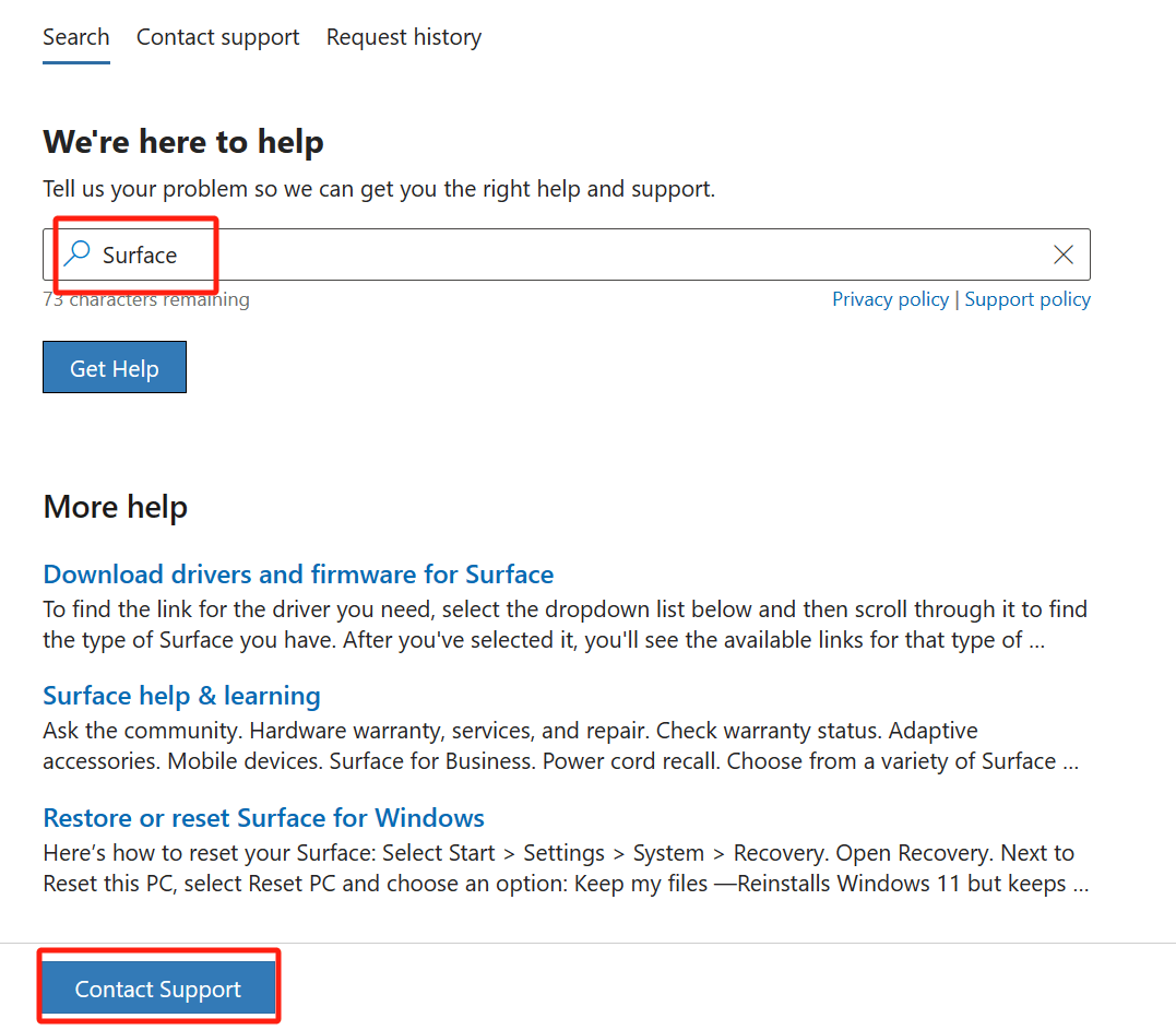

    1. Use your personal Microsoft account (not your organization account) to access the following links:
    Contact - Microsoft Support
    1. Type Surface, press Enter, and click "Contact Support" at the bottom:

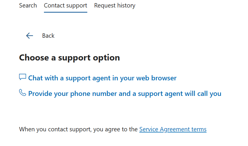

    1. Select Technical Support and select the device model you are currently using in Produce family, then click Confirm:
    1. You will see contact options for Chat support and Phone support, please contact them during business hours:
