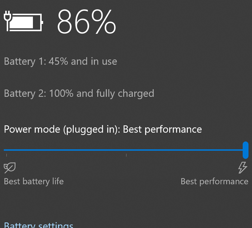

Hi, I have a issue regarding my Surface Book 3. It currently won't charge through the base and won't use battery 2. When it is attached to the base, it detects battery 2 and can show the percentage of battery 2, but never displays battery 2 as "in use", instead, it rapidly drains from battery 1, which is the only one shown as "in use". If I connect charger to the base, battery 2 can be charged (and the system can display the charging status), but battery 1 stays "in use" and does not get charged at all. If I detach the Surface and connect it directly to charger, then the battery 1 gets charged correctly.
While I can attach it to the base, use for about 1 hour or so, and then detach and charge, this is quite an inconvenience.
I feel weird that it can detect battery 2, report percentage from battery 2, and show the charge status of battery 2, but simply cannot use it and cannot charge battery 1 through it. What should I do to fix this? Thanks.

    2021-05-04T03:04:13+00:00
    I tried these but the problem is still there. Currently the Surface Book 3 is attached to the dock and I see the following, so Battery 2 is just sitting there and Battery 1 is being drained. Thanks.

    2021-05-08T15:26:13+00:00
    Hi, when the charger is directly connected to the device (the display part), battery 1 can be charged without problem. Also, now the situation changed a little: when I connect the device to the base, it shows battery 2 "in use" too (previously it only shows battery 2's percentage, but does not show it as "in use"), but battery 1 still discharges at a rapid rate and battery 2 seems not to go down at all. And when I connect charger to base, battery 1 still does not seem to get charged. Thanks.
  5. Anonymous
    2021-05-08T15:47:14+00:00
    One other thing that I noticed is that now the base keyboard is always lit up when the device is attached to the base. I don't think this was the case before, thanks.
