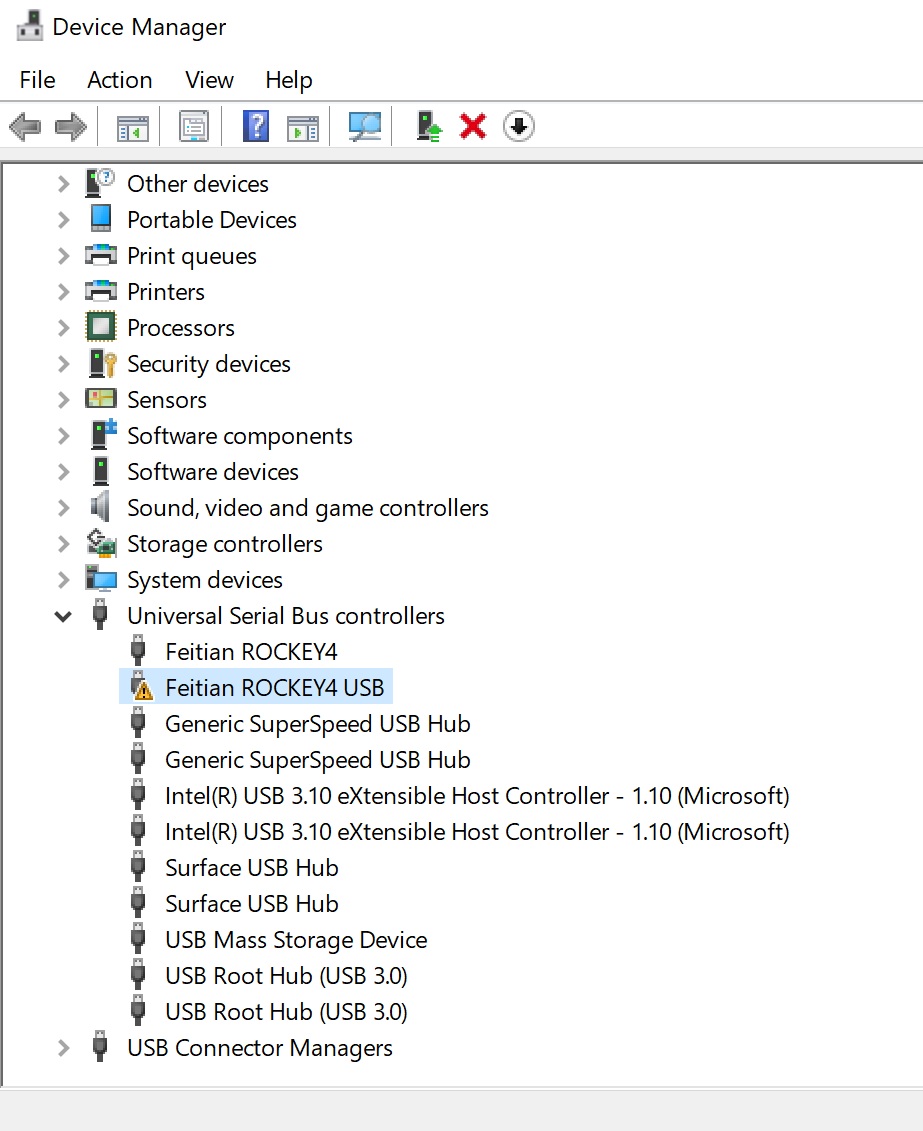

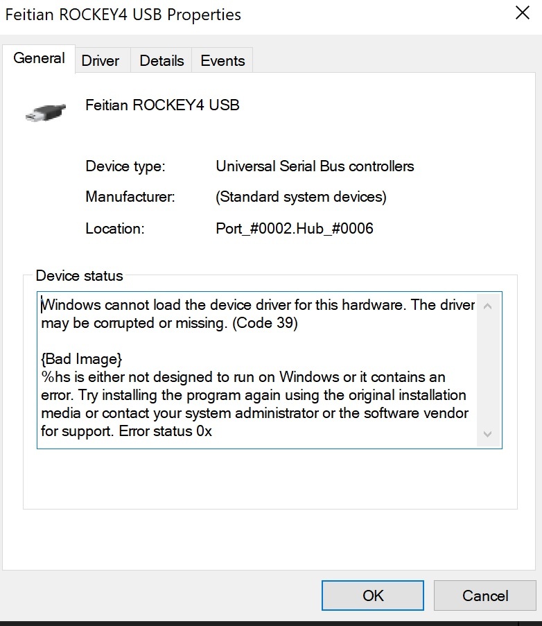

    Update...
    Here is what the device driver shows...and reminder, this has happened on two separate Surface Book 3 devices...
    2021-04-28T13:16:16+00:00
    Found this on another post and this was the resolution for me...
    Go into Regedit...
    HKEY_LOCAL_MACHINE\SYSTEM\CurrentControlSet\Control\DeviceGuard\
    Scenarios\HypervisorEnforcedCodeIntegrity
    Then set the DWORD value Enabled to 0  and reboot. It worked perfectly.
