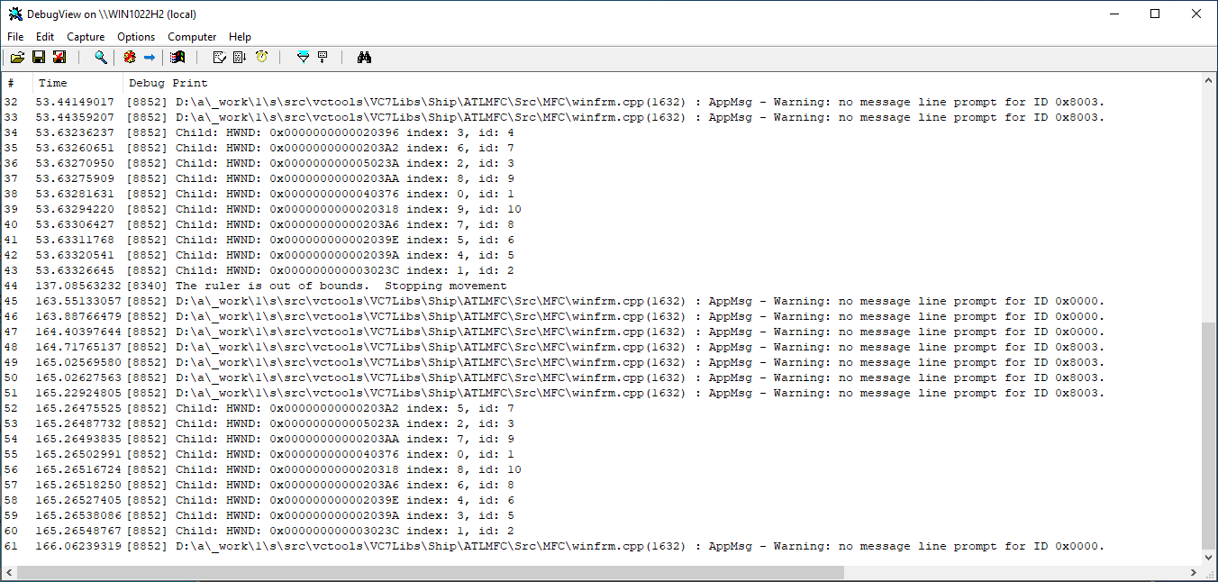

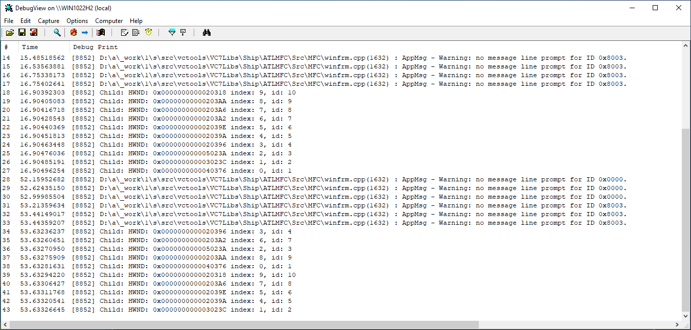

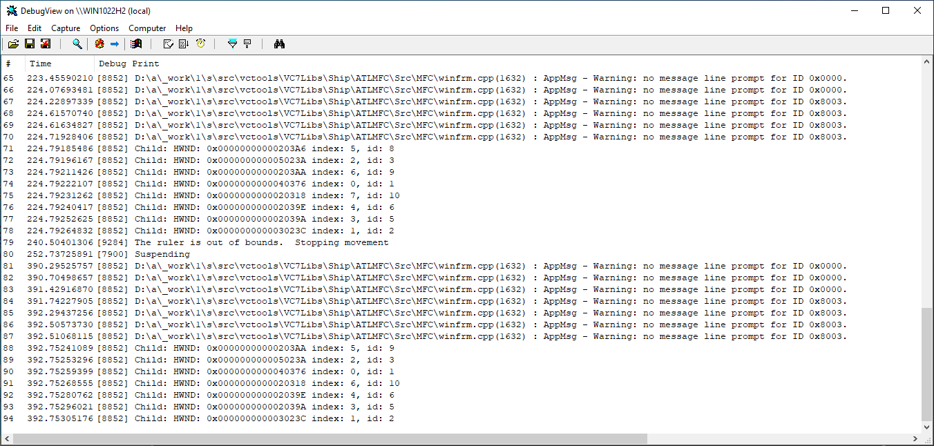

    I also added some code to display the MDI child window z order and also the activation history so you can see that they are synchronized.
    void CMainFrame::OnHelpListchilds()
        // TODO: Add your command handler code here
        HWND hChild = ::GetWindow(m_hWndMDIClient, GW_CHILD);
        CWnd* pWnd = CWnd::FromHandle(hChild);
        while (pWnd)
            if (pWnd->IsKindOf(RUNTIME_CLASS(CMDIChildWndEx)))
                auto c = static_cast<CMDIChildWndEx*>(pWnd);
                auto ptc = c->GetRelatedTabGroup();
                auto tab = ptc->GetTabFromHwnd(c->GetSafeHwnd());
                CTTDoc* pDoc = static_cast<CTTDoc*>(c->GetActiveDocument());
                _RPTN(_CRT_WARN, "Child: HWND: 0x%p index: %d, id: %d\n", c->GetSafeHwnd(), tab, pDoc->m_nDocId);
            pWnd = pWnd->GetNextWindow();
        for (auto& f : m_activationHistory)
            CMDIChildWndEx* pChild = DYNAMIC_DOWNCAST(CMDIChildWndEx, FromHandle(f));
            auto ptc = pChild->GetRelatedTabGroup();
            auto tab = ptc->GetTabFromHwnd(f);
            _RPT2(_CRT_WARN, "History: Child 0x%p, index: %d, id: %d\n", f, tab, (DYNAMIC_DOWNCAST(CTTDoc, pChild->GetActiveDocument()))->m_nDocId);
    I look forward to the results of your next round of testing. :)
