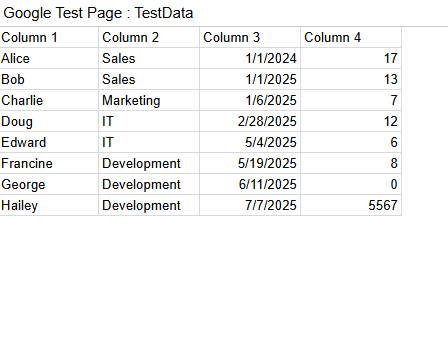

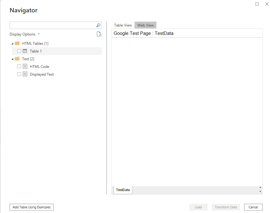

As of August 1st, none of the connections that I had in Power BI that were looking at Google Sheets via the 'Publish to Web' URLs are working. The issue seems to be that the Power Query web connector sees the header of the report title, but not the actual content of the published web page.
For example, when I try to link to the following test page using the 'Web Connector': https://docs.google.com/spreadsheets/d/e/2PACX-1vSa8wC8gKcRb7Ac45llfvGWti0LWO88t_TMy1MRPUo1PTSUxDg0gtsTXTXEvbELcOG4eVIN3_aMc9vW/pubhtml?gid=0&single=true
This is what I end up seeing:
Does anyone have any insight into why this happened?

    Hi Cary. Google recently changed how its “Publish to Web” output works for Google Sheets. Power BI’s Web connector depends on reading static HTML tables, but as of August 2025, the /pubhtml URL no longer provides the table data in a format Power BI can detect.

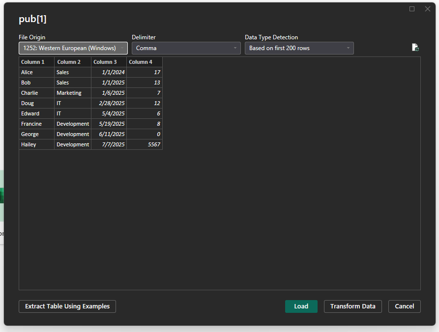

    To this CSV output link instead:
    https://docs.google.com/spreadsheets/d/e/2PACX-1vSa8wC8gKcRb7Ac45llfvGWti0LWO88t_TMy1MRPUo1PTSUxDg0gtsTXTXEvbELcOG4eVIN3_aMc9vW/pub?gid=0&single=true&output=csv
    After that, reload your data in Power BI. I just tested it, and it pulls the data correctly now:
    Give it a try and let me know if it works for you.
