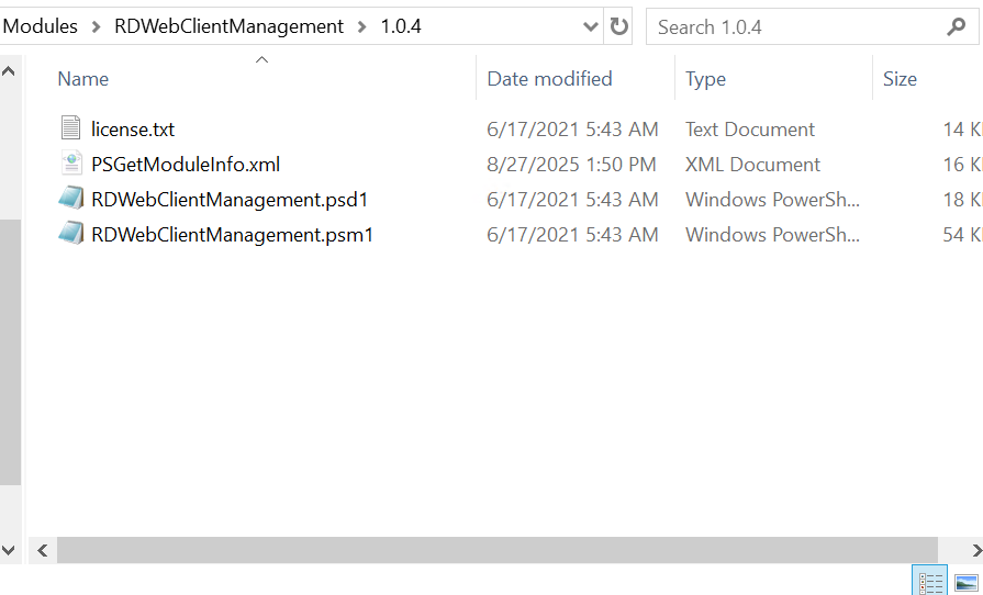

  4. Misko Stanivukovich 25 Reputation points
    2025-08-21T08:04:55.3566667+00:00
    Logs:
    #Fields: date time s-ip cs-method cs-uri-stem cs-uri-query s-port cs-username c-ip cs(User-Agent) cs(Referer) sc-status sc-substatus sc-win32-status time-taken
    2025-08-21 07:57:19 131.176.170.XXX POST /RDWeb/Pages/en-US/login.aspx - 443 dc01\tecmit 131.176.170.XXX Mozilla/5.0+(Windows+NT+10.0;+Win64;+x64)+AppleWebKit/537.36+(KHTML,+like+Gecko)+Chrome/139.0.0.0+Safari/537.36 https://tc-testlab.tecm.esa.int/RDWeb/webclient/ 302 0 0 17
    For Event Viewer logs under Applications and Services Logs → Microsoft → Windows → TerminalServices-WebAccess I dont see folder with that name
    Also for %ProgramData%\RDWebClientManagement\Logs no folder for Rd
