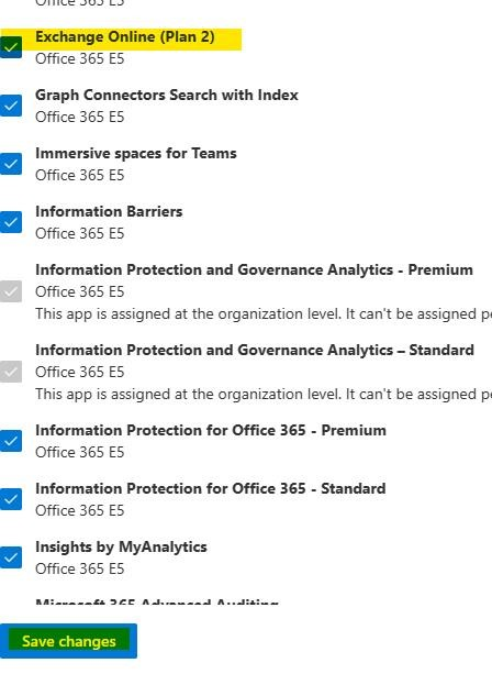

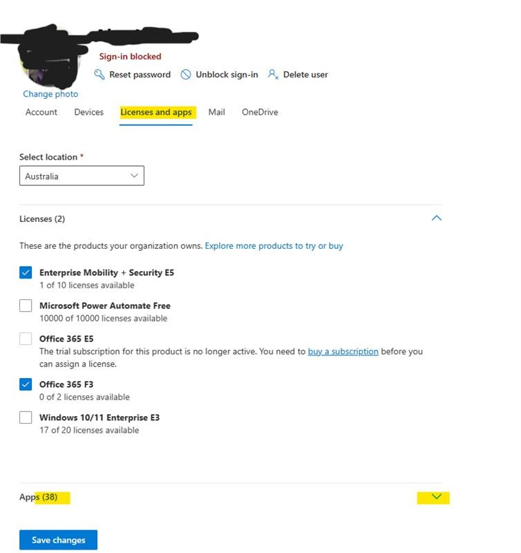

    May I double confirm that you checked with Admin if your account still has License? To check this kindly sing into https://admin.microsoft.com/ with Admin credentials--> choose Active User under Users-->click on your username--> choose Licenses and apps-->Expand Apps--> Make sure that Exchange Online(Plan1 or 2) is selected. If your account has License kindly uncheck it and reapply it then wait the sync period to see if it will make any difference  User's image
    User's image If you don't have Admin privilege, kindly contact your organization Admin to check above for you.
    After performing license checks or role adjustments, it’s also important to clear your browser cache, as outdated session data may interfere with updates.
    You may also refer to Getting a mailbox not found error in Outlook on the web - Microsoft 365 admin | Microsoft Learn.
