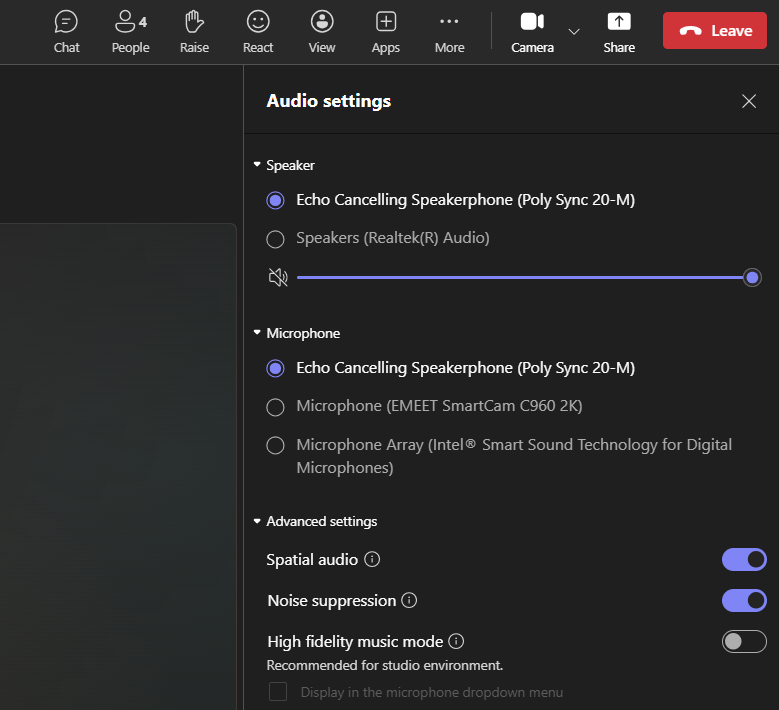

We're having some problems with Teams breakout rooms. Some of the attendees are missing their mics and can't use mics when they join the breakout rooms. It's happening in almost all the meetings. May I know any solutions for this?

    • Verify mic permissions in Teams settings: Go to Settings > Devices and confirm the correct mic is selected.
