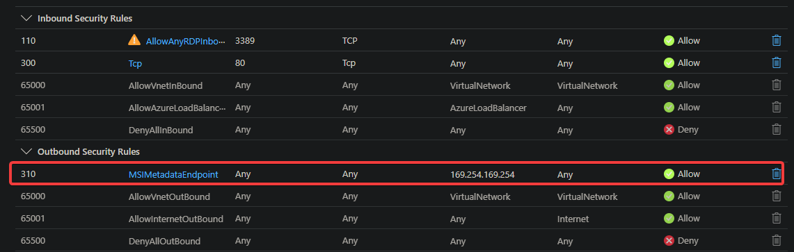

      "msiEndpoint":  "http://169.254.169.254/metadata/identity/oauth2/token",

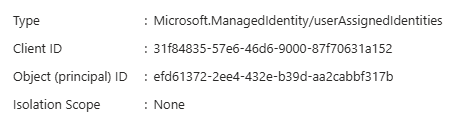

The VMSS is set up with a User Assigned Managed Identity, which has these properties:
The msiClientId in the JSON is the Client ID of the Managed Identity. The msiEndpoint was taken from your Azure documentation. I cannot find any other resource that explains what to put there.

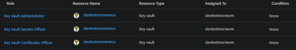

Also, some additional information. If I run this .NET code on the VM, it runs successfully, which indicates that the VM has got access to the Key Vault, but it is the Extension specifically that is not working.
