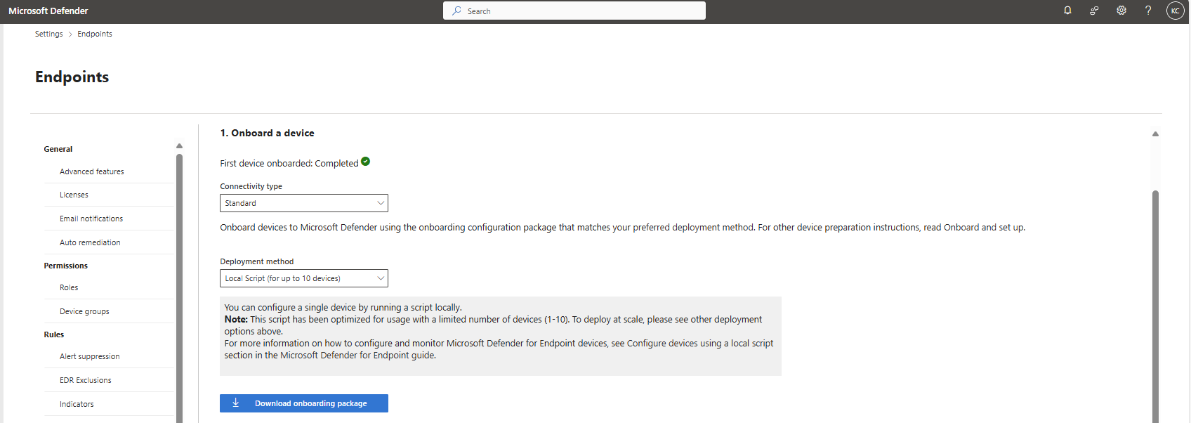

    MDE.Windows Extension (Microsoft Defender for Endpoint)
    The MDE.Windows extension is used to onboard non-Azure machines (via Azure Arc) into Microsoft Defender for Endpoint (MDE). This enables advanced threat protection, endpoint detection and response (EDR), and integration with Microsoft Defender for Cloud .
    Key Functions:
    • Installs the Defender for Endpoint agent.
    • Enables telemetry and threat detection on hybrid/on-prem machines.
    • Can be deployed manually or automatically via Defender for Servers.
    Important Notes:
    • If this extension is not installed, the machine will not be onboarded to Defender for Endpoint.
    • Removing it will disable endpoint protection and stop telemetry from being sent to Microsoft Defender for Cloud.
