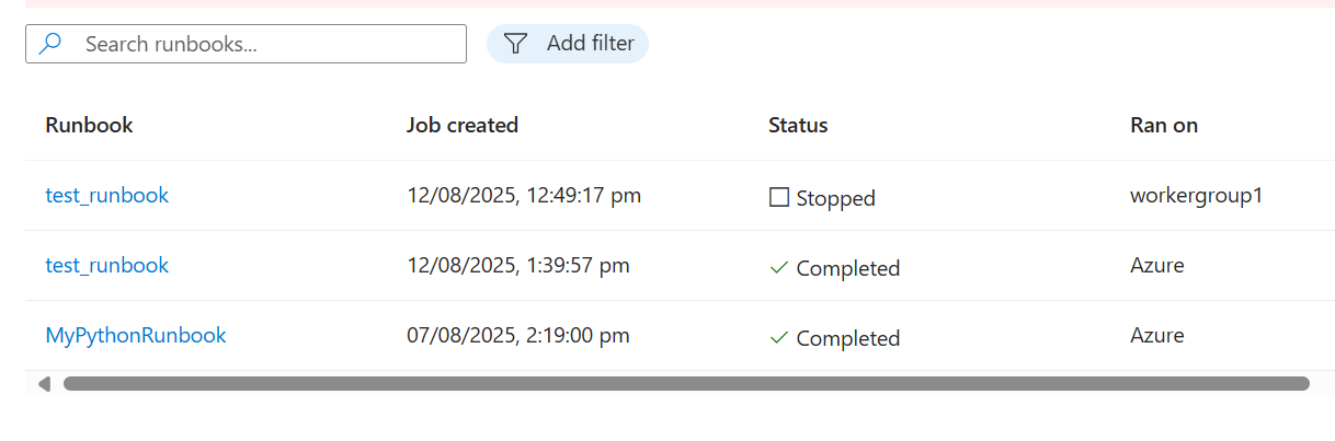

I have only 1 hybrid worker group and only 1 runbook that I am trying to run still getting this error. Attaching the image of the jobs that I ran. I need to know if I am able to connect to the server and run the job or not. Script I am trying to run is

    From the screenshot you attached, we can see that the same runbook executes successfully when it runs on Azure but gets suspended when it targets your Hybrid Worker Group. This confirms that the runbook code itself is valid, and the issue lies specifically with the Hybrid Worker’s communication with Azure Automation.
