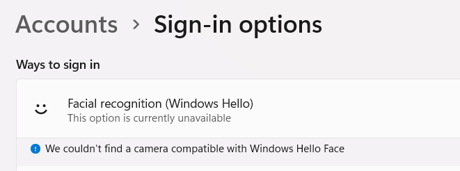

I have a brand new Microsoft Surface Laptop. Out of the box, the camera won't work to sign in with Windows Hello. It says the camera is not compatible with Windows Hello.

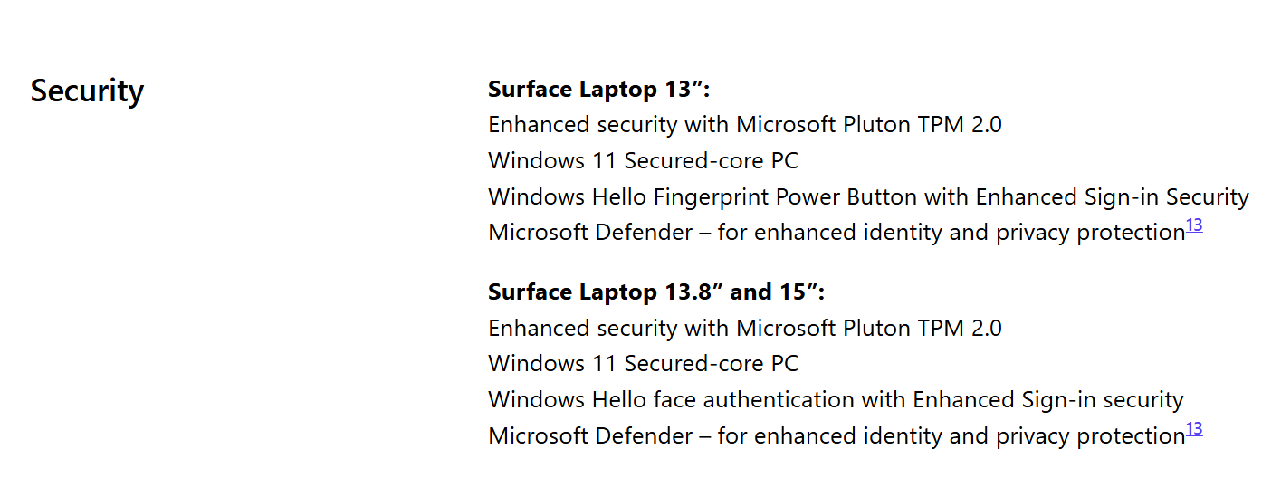

  1. Barb Bowman 78,585 Reputation points MVP Volunteer Moderator
    2025-08-15T13:23:01.9266667+00:00
    Jenny,
    The 13" does not have facial recognition/Windows Hello - it has a fingerprint reader - https://www.microsoft.com/en-us/surface/devices/surface-laptop#tech-specs-uid66f1

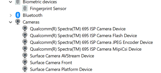

  1. Jeric 1,685 Reputation points Independent Advisor
    2025-08-13T14:43:16.33+00:00
    Hi Jenny,
    If Windows Hello facial recognition isn’t working on your Surface Laptop, first check Device Manager > Cameras to see if an IR camera (Surface Camera Windows Hello) is listed. If only a regular front camera appears, the device may not support facial recognition. Go to Settings > Accounts > Sign-in options to confirm if Windows Hello is available. If it’s grayed out, it could be a hardware or firmware issue. Next, check for updates under Windows Update > Advanced Options > Optional Updates, and install any listed under “Surface Firmware” or “Camera.” Lastly, run the Surface Diagnostic Toolkit from Microsoft’s site to check for compatibility issues. Let me know if any of these will work on your end.

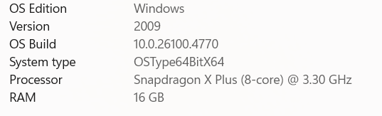

  2. Jeric 1,685 Reputation points Independent Advisor
    2025-08-15T13:17:39.5833333+00:00
    Hi Jenny,
    Since you said that your device is the 1st Edition with Snapdragon. I'm guessing that it was the Surface Laptop, CoPilot+PC 1st Edition, which does not support Windows Hello Face because it lacks an IR camera. Instead, it uses a fingerprint sensor built into the power button for biometric login.
