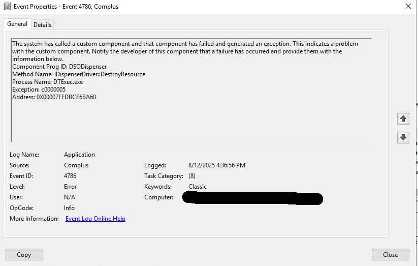

Our SSIS process has been running reliably for over two years without any issues. However, starting in August 2025, we began encountering a consistent crash when loading large Excel (.xlsx) files using the Microsoft.ACE.OLEDB.16.0 driver.
The crash occurs midway through the SSIS execution—log output stops abruptly—and each time, a COM+ error is thrown. Please refer to the attached screenshot from the Windows Application Logs in Event Viewer for details.

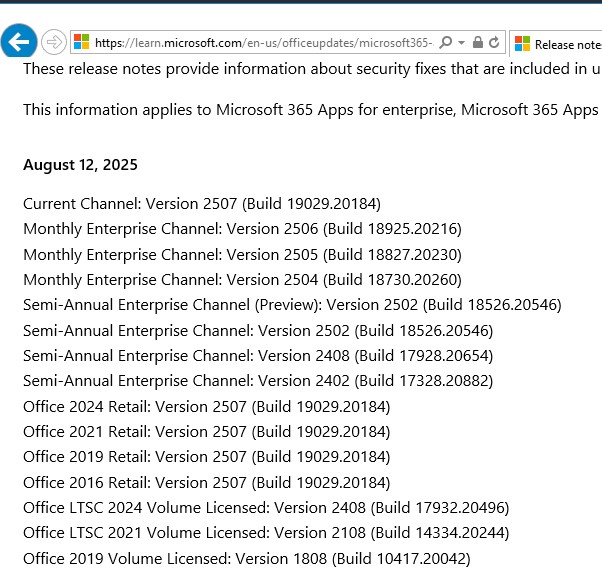

  • The SharedSection parameter in HKEY_LOCAL_MACHINE\SYSTEM\CurrentControlSet\Control\Session Manager\SubSystems\Windows shows no changes to desktop heap.
  • The problem began after recent Windows updates early August 2025, though we are unsure which specific patch introduced the issue. (Our last successful run of the same SSIS package was 7/29/2025. As it's a weekly process, our first occurrence of the SSIS COM+ error was 8/12/2025)
