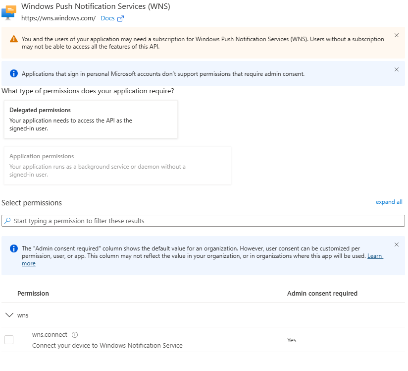

The only thing that seems to be not in sync, but all instructions, and validations imply it should be this way is the Package SID. Notification Hub Settings requires the SID to be prepended with 'ms-app://'. Where as in the Partner Center the SID has no such prefix. Is this an issue?
Where should I be looking to solve this? Is there some undocumented item that I'm missing. Any help would be appreciated.
