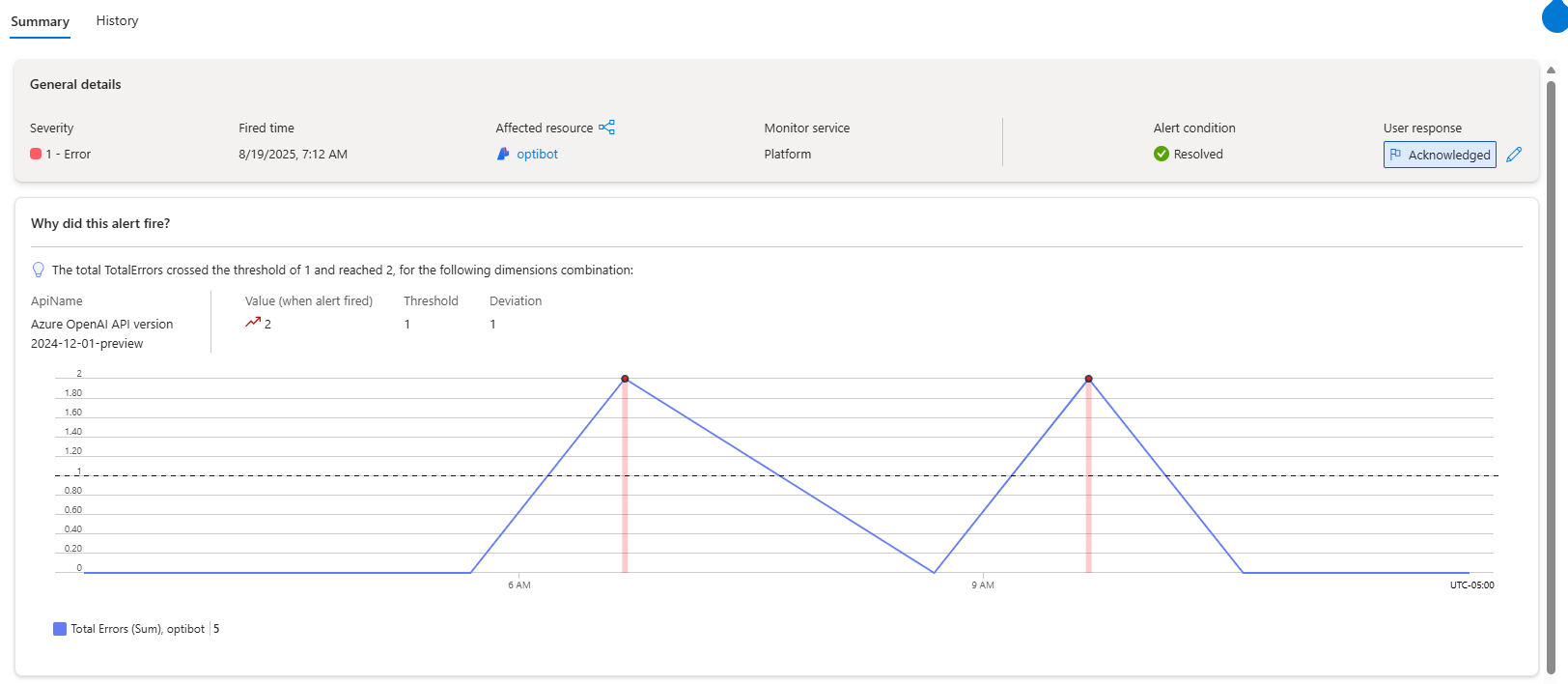

We keep getting an alert from Azure regarding our AI, and while it shows me that there were errors that fired the alert I cannot find out what the specific errors are. I think this is firing due to an API issue, but as I said I cannot actually view the error. How would I go about finding this info? I have queried the logs with queries that seem applicable, but they turn up nothing. 111111

    Hi, What you’re looking at is a metric alert (TotalErrors) on your Azure OpenAI resource; metrics only tell you “how many”, not the actual failures. To see the real errors do this: 1) On the Azure OpenAI resource - Diagnostic settings - Send to Log Analytics (pick a workspace) and enable all log categories (request/response). 2) Wait a few minutes, then open Logs on the resource and run a query like:

    (adjust table names using the Tables pane if your workspace uses the legacy AzureDiagnostics table). 3) In Metrics on the same resource, open the “Total Errors” chart and Split by ApiName and, if available, Response code class to see which API (e.g., ChatCompletions) and which code family (4xx vs 5xx) spiked at the alert time. 4) In your app, log the HTTP failures with the status code, response body error.code/error.message, and headers x-ms-request-id and (optionally set) x-ms-client-request-id so you can correlate app logs ↔ Azure logs. 5) If you front the API with APIM/Front Door, also enable their diagnostics—many “errors” are throttles (429) or auth (401/403). Once diagnostics are flowing, the query above will show the exact calls that fired the alert.

    But as per the provided screenshot we can conclude the error shown in your Azure alert is from a metric, The alert summary specifies that it was triggered because the total errors crossed the threshold
