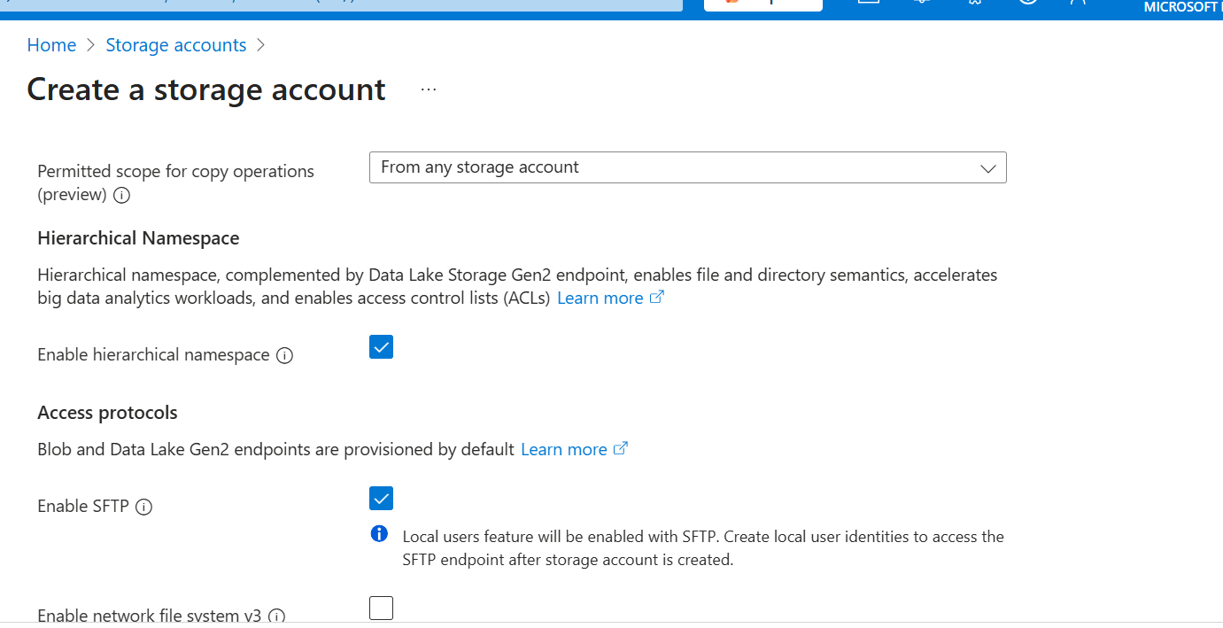

I have a storage account with a container that is watched by Databricks job

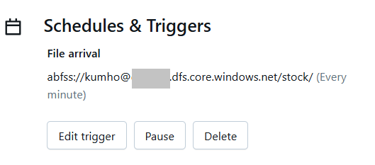

And I have Databricks job that watches the folder in the container.

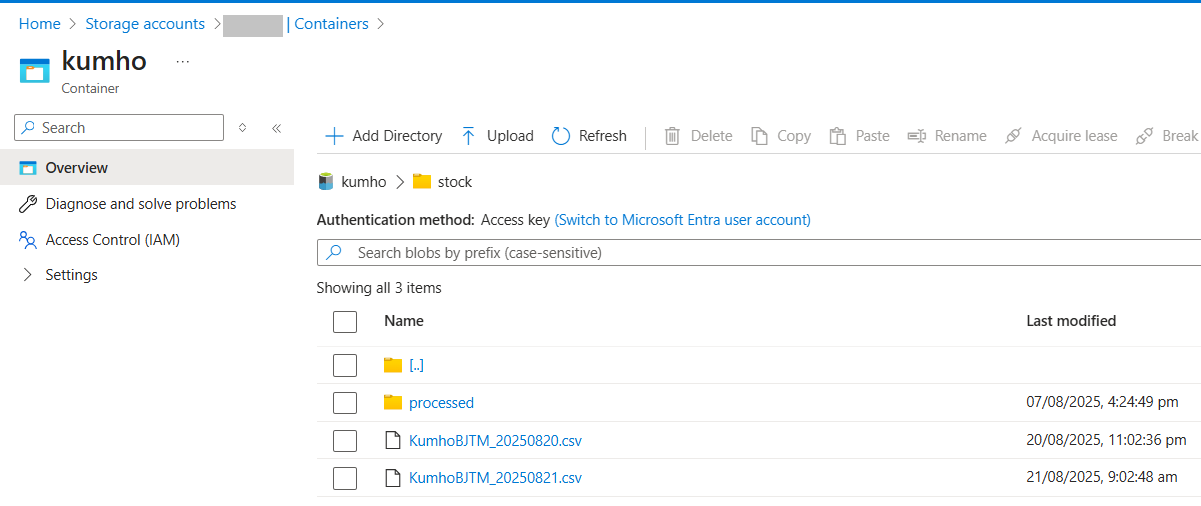

If I upload any file from the container UI, it will trigger the job.

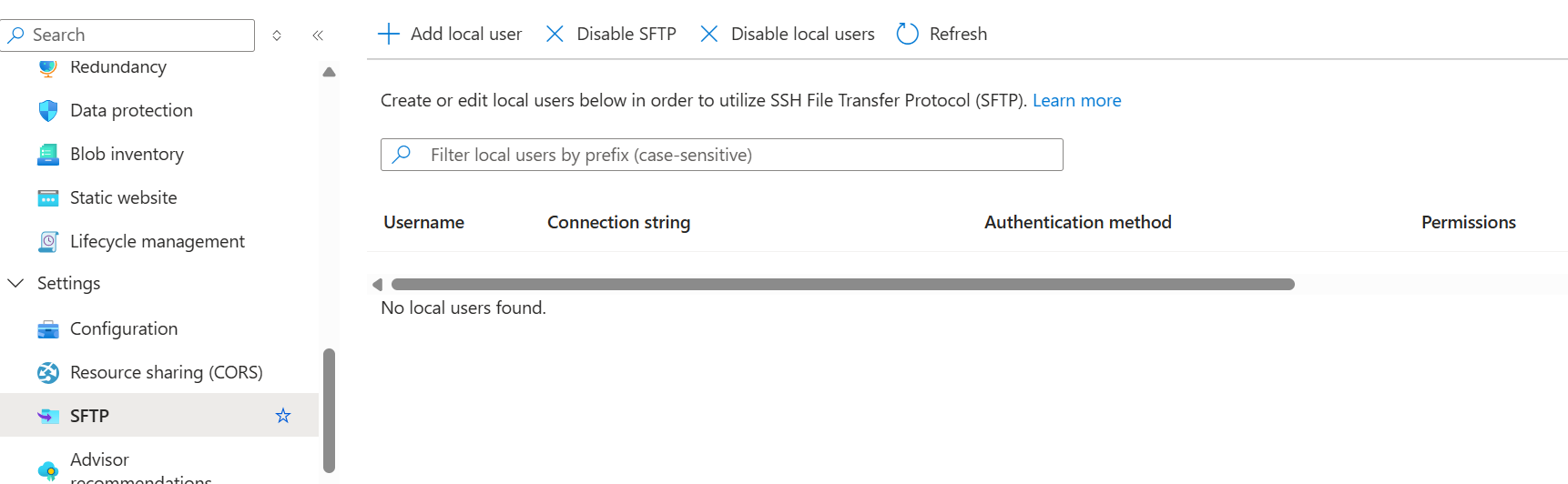

When a 3rd party upload to the container via SFTP, this even is not triggered so files are not processed.

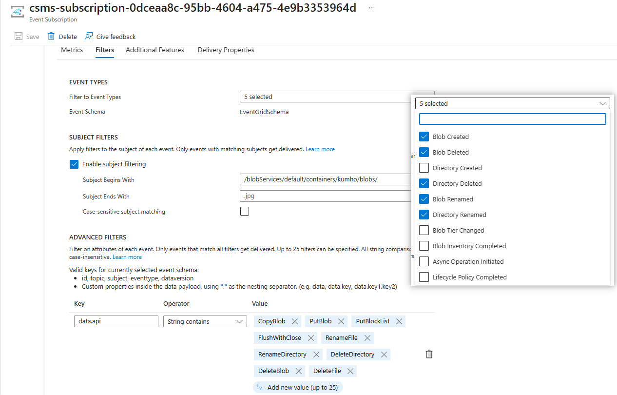

The trigger is setup in Databricks automatically via enabling external storage file events and setting it in the job trigger config.
This is what it created in EventGrid:
Question is what event is missing in which filter to enable SFTP trigger?
