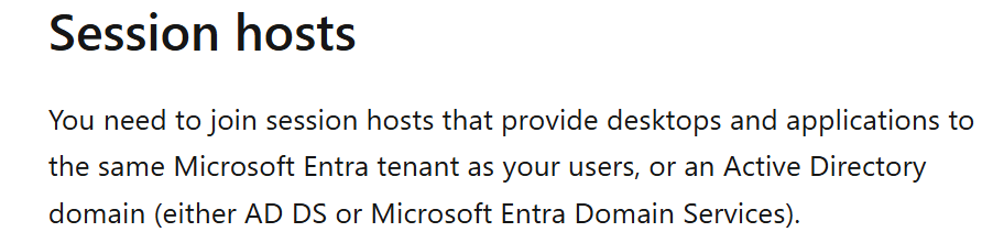

I am trying to deploy AVD in azure local as a POC and below is my brief
My Session Hosts will be part of my onprem private domain(abc.local) that i have created locally and are joined to the domain.
My users are in entra ID (xyz.net) and will be accessing the AVD systems and i have given the assignment.
both the above domains are not connected in any sort
I am not able to view the system in the Remote Desktop.

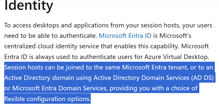

As per below i have the flexibility to joining my session hosts to my onprem domain as well
https://learn.microsoft.com/en-us/azure/virtual-desktop/prerequisites?tabs=portal
https://learn.microsoft.com/en-us/azure/virtual-desktop/authentication#hybrid-identity
but as per below, my session host and the users who access they desktops should also be in the same domain
so does that mean that Azure local only supported identity for AVD, I should have an onprem AD which is in connect with my entra ID or else you will not be able to use AVD in Azure Local.

    In your explanation, this configuration is unsupported because the AVD service broker can only authenticate users against Entra ID and must be able to resolve those identities to session hosts registered in a trusted directory.
    The only viable solution is to establish hybrid identity using Entra ID Connect to synchronize your on-premises Active Directory with Entra ID, creating a single trusted identity source. This requires first ensuring a reliable Site-to-Site VPN or ExpressRoute connection is in place between your on-prem network and the Azure VNet hosting your session hosts, with the VNet's DNS settings configured to use your on-prem domain controllers for name resolution - https://learn.microsoft.com/en-us/azure/virtual-network/virtual-networks-name-resolution-for-vms-and-role-instances
    You must then install and configure Entra ID Connect on a server in your abc.local domain, specifically synchronizing the Organizational Units containing both your users and the session host computer objects - https://learn.microsoft.com/en-us/entra/identity/hybrid/connect/how-to-connect-install-custom
    Once synchronized, you must assign users access using these synchronized identities via the Virtual Machine User Login role in IAM for the host pool or specific VMs. - https://learn.microsoft.com/en-us/azure/role-based-access-control/role-assignments-portal) and
    It is critical to understand that this architecture introduces a dependency on your on-premises infrastructure for authentication; any disruption in network connectivity or the Entra ID Connect service will impact user sign-ins. For a proof-of-concept, this is the required path, but for production, consider the long-term resilience and management overhead of maintaining this hybrid identity dependency.
