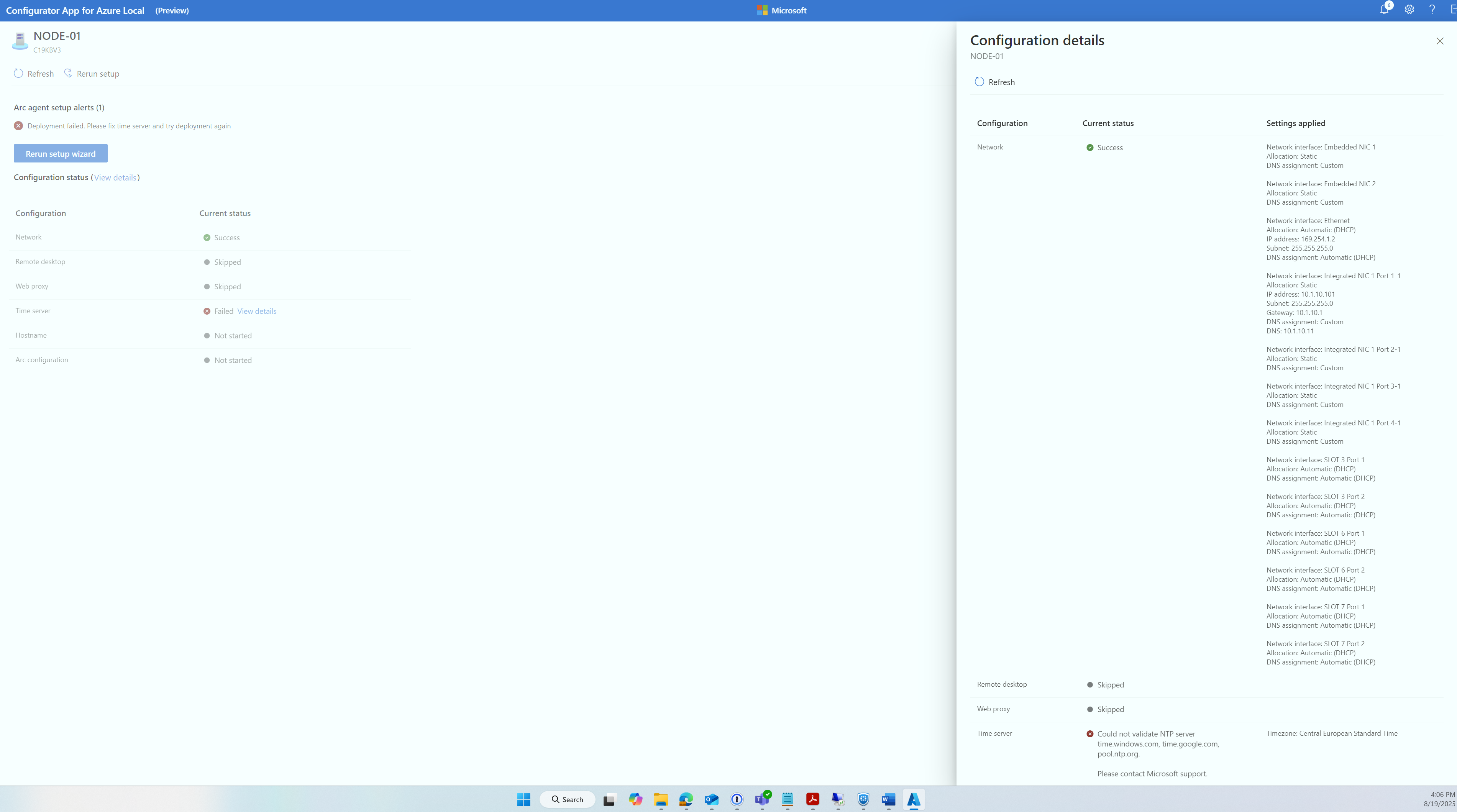

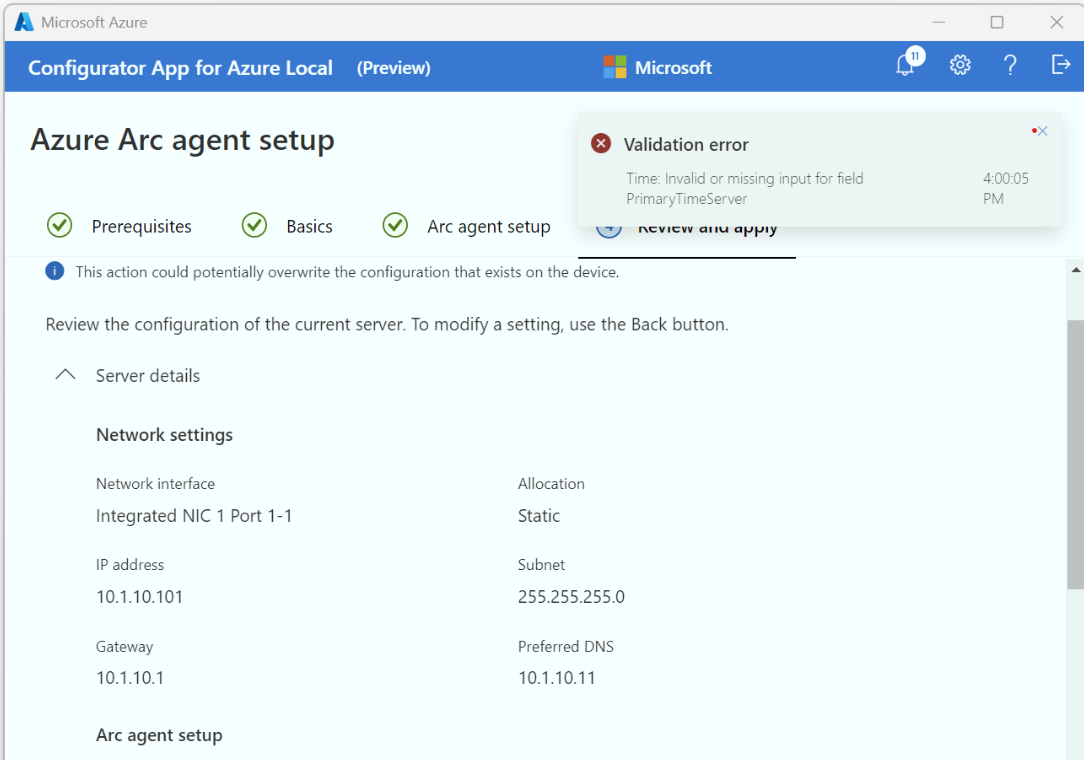

I am receiving this message while connecting nodes using configurator app for Azure Local
"Validation Error - Time Invalid missing input for Field Primary Time Server"
Please advice

  1. Durga Reshma Malthi 11,400 Reputation points Microsoft External Staff Moderator
    2025-08-25T05:47:11.9+00:00
    Hi Rasitha Mudugama Hewage
    Just checking in to see if you had a chance to review the response provided to your question.

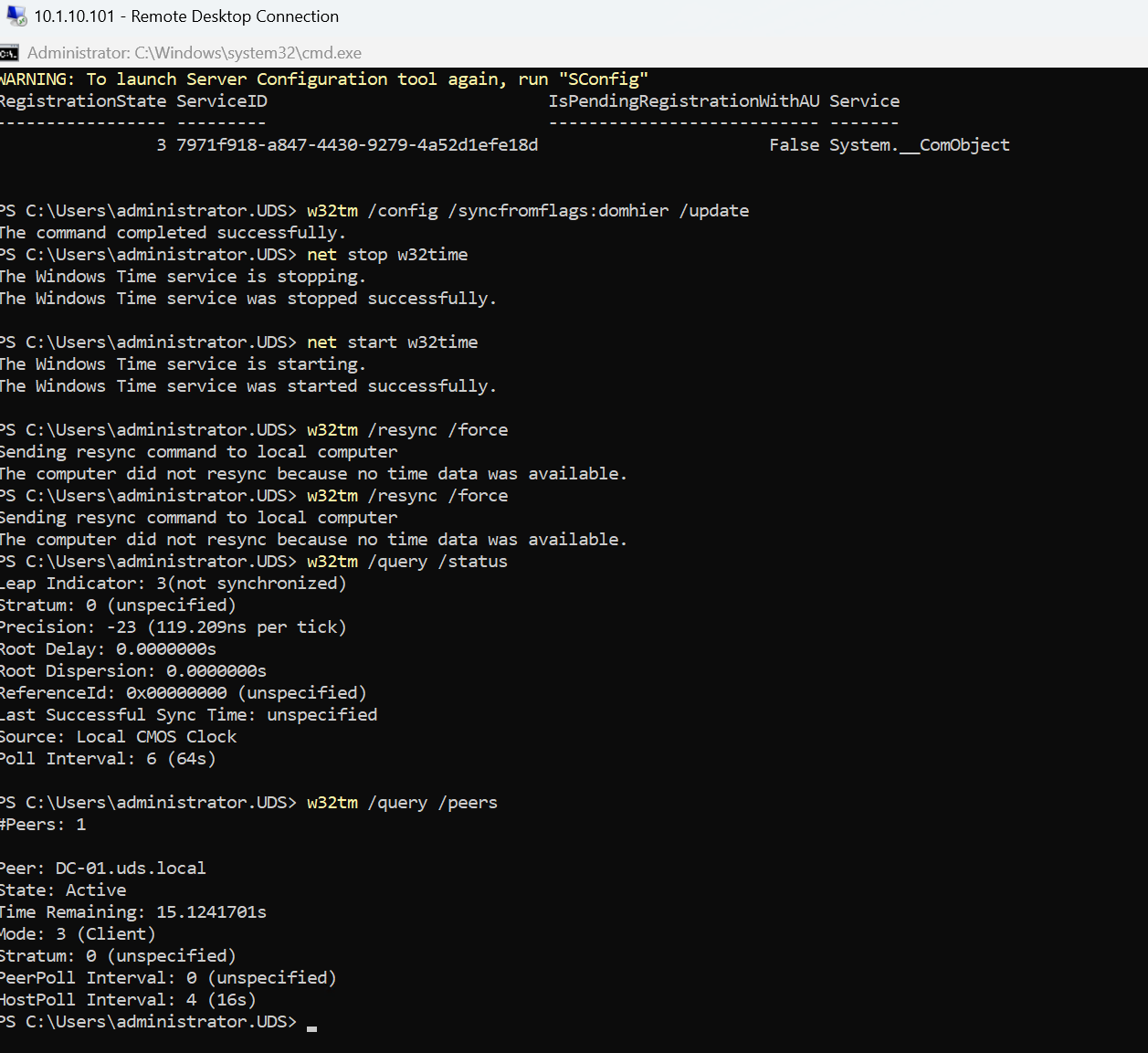

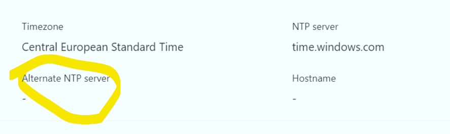

    Use an internal NTP source (recommended in enterprise). Example:
    Primary Time Server: ntp.corp.local
    On the node itself, test:
    w32tm /stripchart /computer:time.windows.com /dataonly /samples:3
    If it fails -> UDP/123 is blocked, or DNS is wrong.
    Or try setting:
    pool.ntp.org
    • Or even the IP address of the NTP server (instead of FQDN).
    Example:
    Primary NTP server: 216.239.35.0 (one of Google’s NTP IPs)
    Feel free to reach out if you have any further queries.

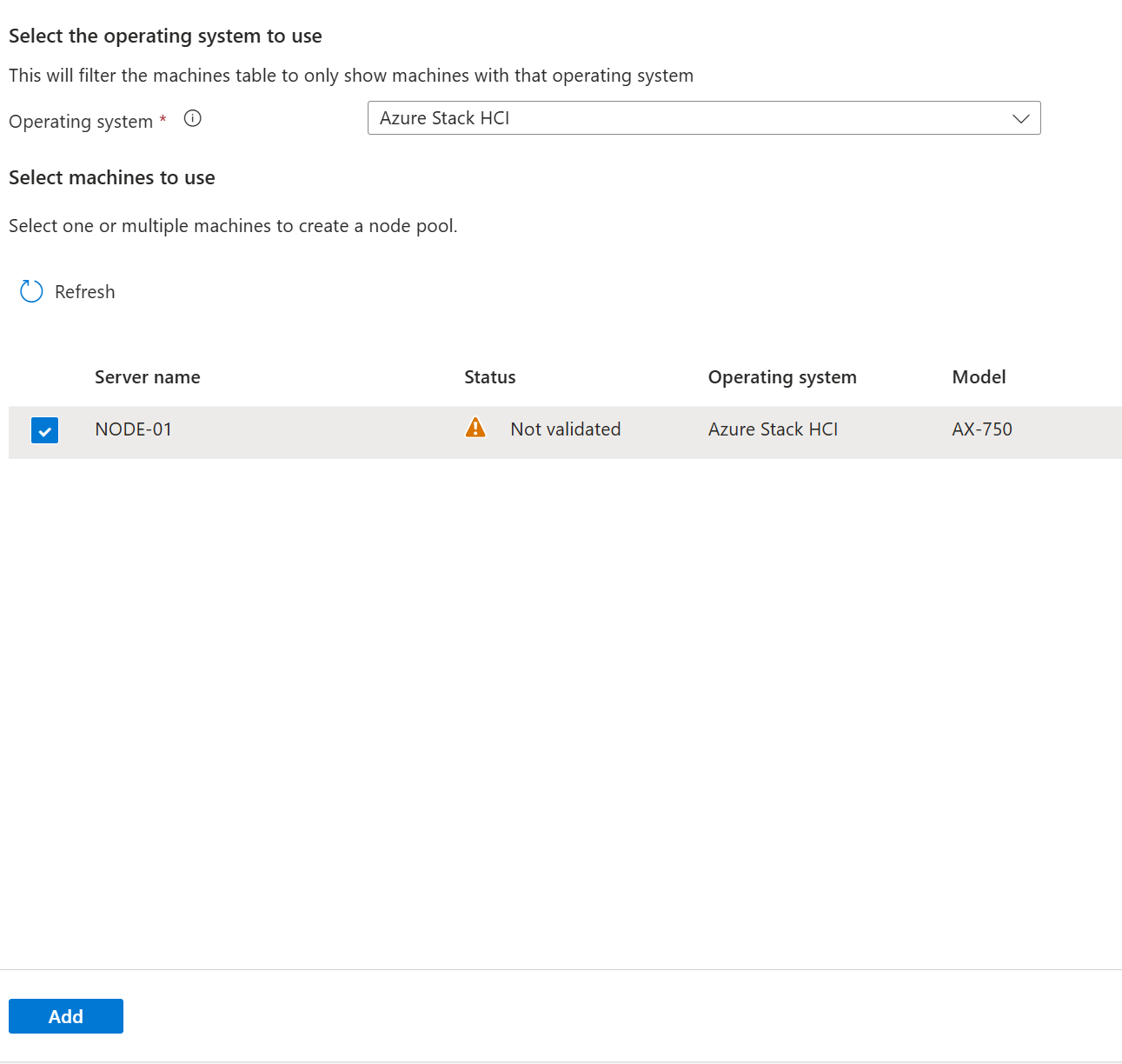

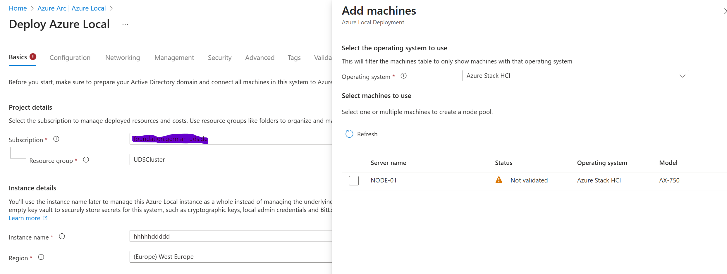

  1. Rasitha Mudugama Hewage 20 Reputation points
    2025-08-25T09:37:23.1933333+00:00
    Hi Everyone,
    Thanks for your support and connected node to azure arc but when i try to create azure local and see this message. " not validated"
