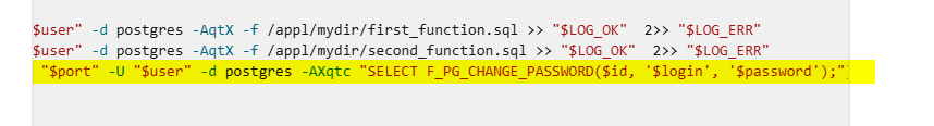

I have tried to install two PL/pgSQL functions, run the second of them, save the output of the function in a variable, export it to an SQL file and run the exported file, using a bash script:
#!/bin/bash
# function to install pg functions into the database
run_sql_commands() {
    local user=$1
    local pass=$2
    local id=$3
    local host=$4
    local port=$5
    local login=$6
    local password=$7
    PGPASSWORD="$pass" /usr/bin/psql -P pager=off -q -t -h "$host" -p "$port" -U "$user" -d postgres -AqtX -f /appl/mydir/first_function.sql >> "$LOG_OK"  2>> "$LOG_ERR"
    PGPASSWORD="$pass" /usr/bin/psql -P pager=off -q -t -h "$host" -p "$port" -U "$user" -d postgres -AqtX -f /appl/mydir/second_function.sql >> "$LOG_OK"  2>> "$LOG_ERR"
    update_var=$(PGPASSWORD="$pass" /usr/bin/psql -P pager=off -q -t -h "$host" -p "$port" -U "$user" -d postgres -AXqtc "SELECT F_PG_CHANGE_PASSWORD($id, '$login', '$password');")
    echo "$update_var" >> /appl/mydir/update_string.sql

I have already tested if the code can connect to the database, and it can. However, it is not installing the functions. They are not in the database. I have already tried to install the functions manually and it works, so it is not a matter of right. I cannot identify the error. Has anyone ever had this problem before?
Is it possible that it has something to do with the fact that the database, where I have tried to install the functions is an Azure database for Postgres? When I try to do the installation manually, it works. So may it be something related to the right to install the functions remotely? That is my only guess, but I have never had this problem before.

    Thank you so much for your patience and for sharing the details, really appreciate it. I’m glad to hear your issue has been resolved. I am adding the steps that you have followed to resolve your issue.
    Here's a corrected Bash script:
    • Explicitly uses the right database (change DB to actual DB if required).
    • Enforces sslmode=require (mandatory on Azure).
    • Surfaces errors by removing quiet flags when installing functions.
    • Logs properly, with least-privilege file permissions
    #!/bin/bash
    # Paths to log files
    LOG_OK="/appl/mydir/logs/success_change_password.log"
    LOG_ERR="/appl/mydir/logs/error_change_password.log"
    # Clear log files at the beginning of the script and add a timestamp
    timestamp=$(date '+%Y-%m-%d %H:%M:%S')
    echo "### SCRIPT EXECUTION LOG FOR PASSWORD CHANGE FROM $timestamp" > "$LOG_OK"
    echo "### ERROR LOG FOR SCRIPT EXECUTION OF PASSWORD CHANGE FROM $timestamp" > "$LOG_ERR"
    # Function to install pg functions into the database
        local user=$1
        local pass=$2
        local id=$3
        local host=$4
        local port=$5
        local login=$6
        local password=$7
        local dbname="postgres"
        # Install first function
        PGPASSWORD="$pass" /usr/bin/psql "host=$host port=$port user=$user dbname=$dbname sslmode=require" \
            -v ON_ERROR_STOP=1 -f /appl/mydir/first_function.sql >> "$LOG_OK" 2>> "$LOG_ERR" || return 1
        # Install second function
            -v ON_ERROR_STOP=1 -f /appl/mydir/second_function.sql >> "$LOG_OK" 2>> "$LOG_ERR" || return 1
        # Call function and capture output
        update_sql="SELECT second_function($id, '$login', '$password');"
        update_var=$(PGPASSWORD="$pass" /usr/bin/psql "host=$host port=$port user=$user dbname=$dbname sslmode=require" \
            -AXqtc "$update_sql" 2>> "$LOG_ERR") || return 1
        echo "$update_var" > /appl/mydir/update_string.sql
        chmod 640 /appl/mydir/update_string.sql
        return 0
    # Read input arguments line by line
    while read -r i j k l m; do
    id="$i"
     host="$j"
     port="$k"
     login="$l"
    password="$m"
        # Load user info and password for DB connection from .env
        while IFS='=' read -r key value; do
            case "$key" in
                "USER2") user="$value" ;;
                "PASSWORD") pass="$value" ;;
                "USER4") user2="$value" ;;
                "PASSWORD4") pass2="$value" ;;
            esac
        done < /appl/mydir2/.env
        if [ -n "$user" ] && [ -n "$pass" ]; then
            echo "[$(date '+%Y-%m-%d %H:%M:%S')] Connecting to host: $host, port: $port with USER2" >> "$LOG_OK"
            if run_sql_commands "$user" "$pass" "$id" "$host" "$port" "$login" "$password"; then
                echo "[$(date '+%Y-%m-%d %H:%M:%S')] Connection to host: $host, port: $port with USER2 was successful" >> "$LOG_OK"
            elif [ -n "$user2" ] && [ -n "$pass2" ]; then
                echo "[$(date '+%Y-%m-%d %H:%M:%S')] Connecting to host: $host, port: $port with USER4" >> "$LOG_OK"
                run_sql_commands "$user2" "$pass2" "$id" "$host" "$port" "$login" "$password"
            else
                echo "[$(date '+%Y-%m-%d %H:%M:%S')] Failure to connect to host: $host, port: $port" >> "$LOG_ERR"
            fi
        else
            echo "[$(date '+%Y-%m-%d %H:%M:%S')] User or password not found in .env file" >> "$LOG_ERR"
        fi
    done < /appl/mydir/var_select.txt
    # Clean up
    rm -f "/appl/mydir/var_select.txt" 2>> "$LOG_ERR"
    rm -f "/appl/mydir/update_string.sql" 2>> "$LOG_ERR"
