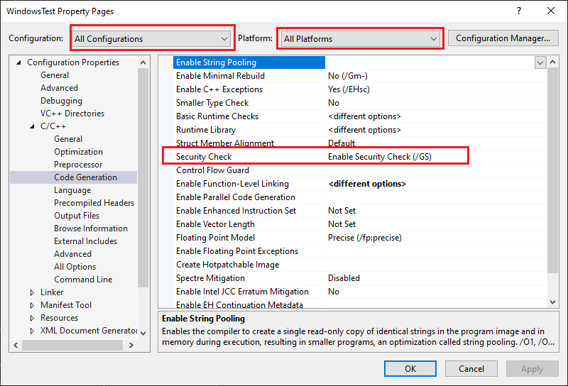

  2. Omkara Varshitha Kunapalli (INFOSYS LIMITED) 385 Reputation points Microsoft External Staff
    2025-08-26T06:40:39.5733333+00:00
    Thanks for reaching out !
    **Stack Protection Disabled in Process Explorer
    1. Stack Protection is a compile-time security feature that helps detect and prevent stack-based buffer overflows. It is typically enabled using the /GS compiler flag during compilation.
    2. If the executable is a .NET managed application, Stack Protection may show as Disabled in Process Explorer. This is expected behavior because managed code uses different memory safety mechanisms.
    3. If the executable is a native (unmanaged) application, Stack Protection being disabled could indicate that it was compiled without the /GS flag. This may expose the application to stack-based buffer overflow risks.
    4. The presence of DEP, ASLR, and CFG indicates that other runtime protections are active, which significantly reduce exploitability.
    5. Security Impact: For managed applications, this is not a concern. For native applications, it is recommended to enable Stack Protection during compilation to enhance security.
