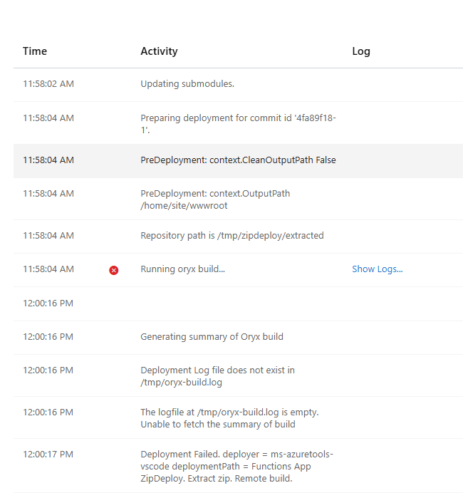

When I am trying to deploy the python based azure function using Visual Studio code facing issue as below:
ERROR at stage Running oryx build: Could not find a version that satisfies the requirement azure-functions==1.23.0 (from versions: none)
ERROR: No matching distribution found for azure-functions==1.23.0 | Exit code: 1 | Please review your requirements.txt | More information: https://aka.ms/troubleshoot-python
\n/opt/Kudu/Scripts/starter.sh oryx build /tmp/zipdeploy/extracted -o /tmp/build/expressbuild --platform python --platform-version 3.12 -i /tmp/8dde469b692120d -p packagedir=.python_packages/lib/site-packages
For all the packages listed in requirements.txt facing above error and even I tried passing packages without versions still facing similar issue. Can't recognize what is the root cause of the issue.

    The Oryx build steps may be failing because the function app cannot reach pypi.org to pull the libraries. Please check below and let me know if it helps.
    1. If your Function App uses regional VNet Integration: inspect the subnet’s NSG outbound rules and the route table / NAT gateway. Allow outbound HTTPS (port 443) to pypi.org (or to the NAT public IPs used by the subnet).
    2. If your org uses a proxy, ensure the proxy settings are available to the build environment (set HTTP_PROXY / HTTPS_PROXY).
    3. If you use a private PyPI feed, make sure it mirrors required packages or add --extra-index-url https://pypi.org/simple (or set PIP_EXTRA_INDEX_URL environment variable) so the build can fall back to PyPI. In requirements.txt:
      OR pip config (~/.config/pip/pip.conf or /etc/pip.conf):
         [global]
         extra-index-url = https://pypi.org/simple
    Reference: https://learn.microsoft.com/en-us/answers/questions/2117785/azure-function-kudu-not-recognizing-pip
