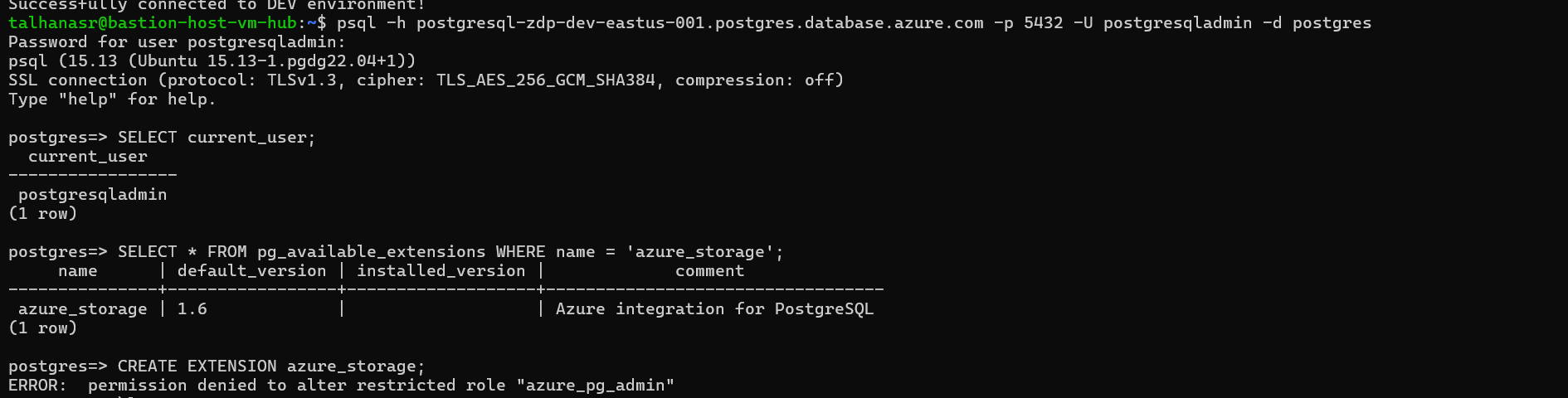

- Run:
SELECT current_user;

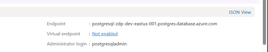

- This should match your admin account login.
- Check if the extension is available:
SELECT * FROM pg_available_extensions WHERE name = 'azure_storage';
- If its available, try to create the extension.
Please let us if you still getting same issue so that we can try guide possible ways.

Talha Nasr • 25 Reputation points
2025-08-27T11:48:41.6633333+00:00 I followed the steps and verified that I am using server administrator login but still getting same error.

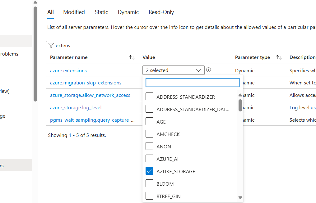

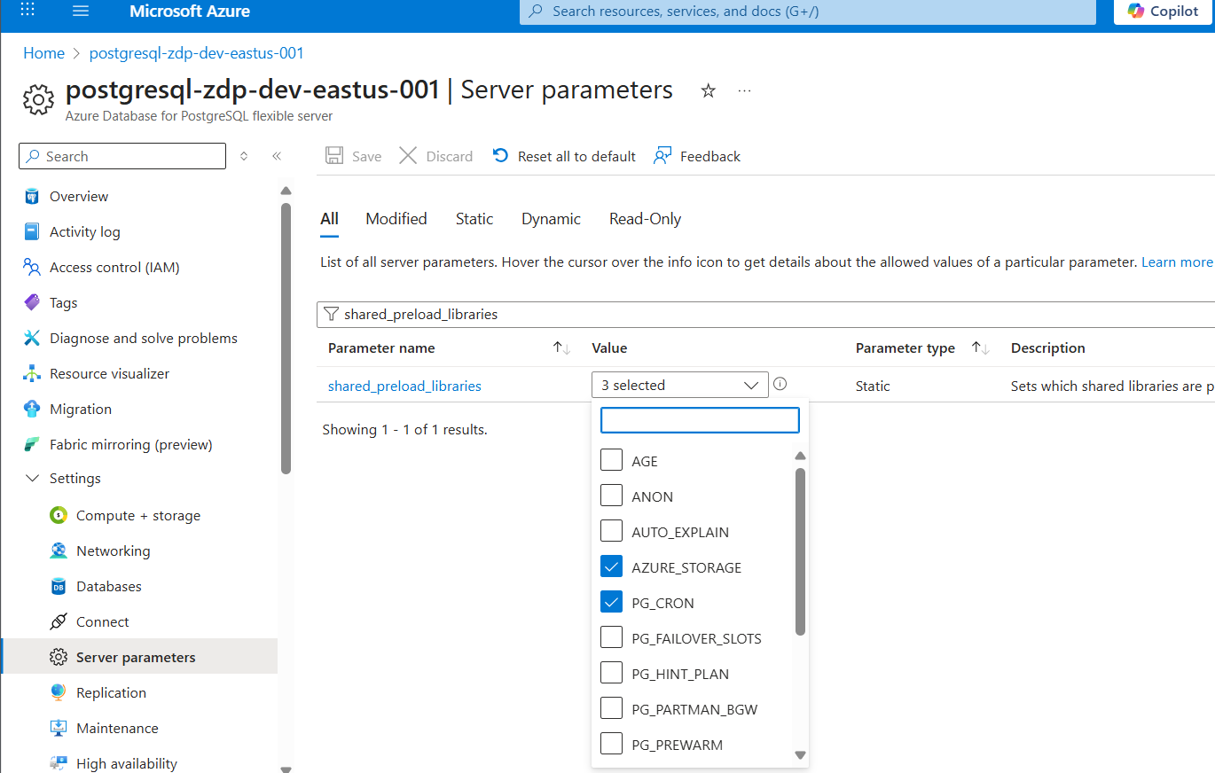

2025-08-27T16:06:22.5933333+00:00 yes, I have done the prerequisite steps mentioned in the docs here:
https://learn.microsoft.com/en-us/azure/postgresql/flexible-server/how-to-configure-azure-storage-extension?tabs=portal-03%2Cportal-04%2Cportal-05%2Cportal-01%2Cportal-02majorly there was following two steps that was related to extension:
- Load the extension's library
- Allowlist the extension
and i will be using the shared key authorization method and for that I did those prerequisite steps.

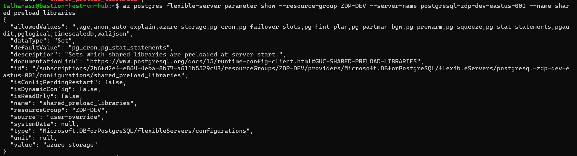

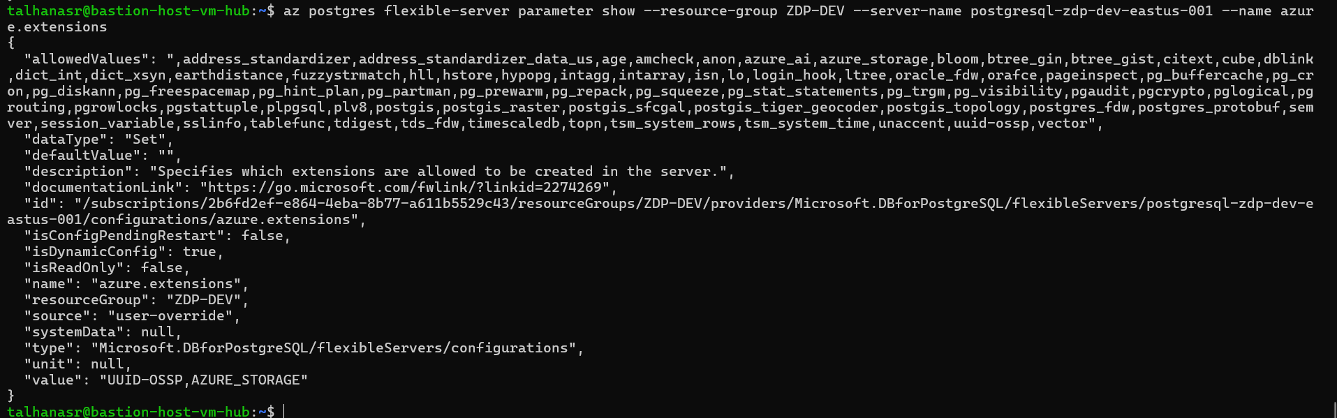

2025-08-27T17:25:20.9066667+00:00 Thanks, Talha Nasr, for your quick response! Can you please share the server parameters you’ve configured, so we can take a deeper look into the problem?
Thanks!
2025-08-27T18:46:25.15+00:00 -
Kalyani Kondavaradala • 1,015 Reputation points • Microsoft External Staff • Moderator
2025-08-28T09:24:33.8666667+00:00 Thank you for sharing the server parameters, Talha Nasr. I can see that the required parameters such as azure.extensions are already configured. Could you please confirm if you have restarted the server after applying these parameter changes and then tested again?
