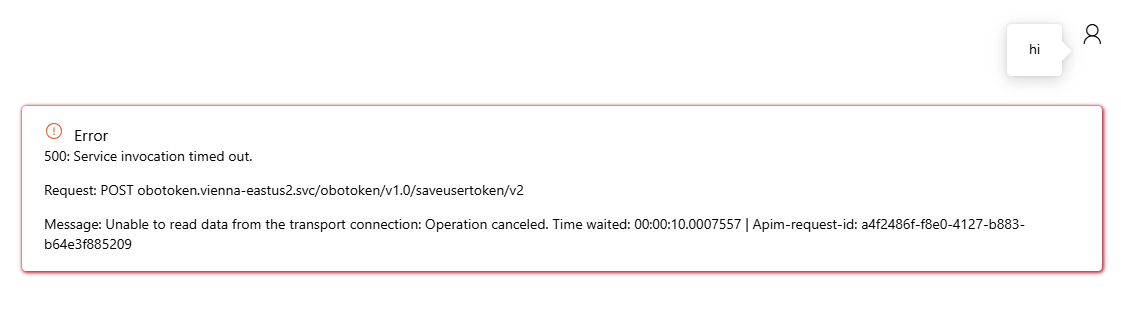

We have noticed an instability around Azure AI Foundry Agent Threads Run with deployment using gpt-4o base model on US East Region. In between agents.runs.create() and agentRun.stream() , there is at least 120s delay before the run has been created and processed.There is no way we can monitor on Azure AI Foundry or other observability services on Azure.
const client = new AIProjectClient(endpoint, new DefaultAzureCredential());
const agentRun: AgentRunResponse = client.agents.runs.create(thread.id, agentId)
const streamMessages = await agentRun.stream();
The endpoint would, occasionally, return rest API error
/Users/bedatse/Developer/ennie/healthis_be/node_modules/@typespec/ts-http-runtime/src/client/restError.ts:27
  return new RestError(message, {
RestError: Service invocation timed out.
Request: POST obotoken.vienna-eastus.svc/obotoken/v1.0/saveusertoken/v2
 Message: Unable to read data from the transport connection: Operation canceled. Time waited: 00:00:09.9986723
    at createRestError (/Users/bedatse/Developer/ennie/healthis_be/node_modules/@typespec/ts-http-runtime/src/client/restError.ts:27:10)
    at createRestError (/Users/bedatse/Developer/ennie/healthis_be/node_modules/@azure-rest/core-client/src/restError.ts:27:30)
    at _createRunDeserialize (/Users/bedatse/Developer/ennie/healthis_be/node_modules/@azure/ai-agents/src/api/runs/operations.ts:360:26)
    at executeCreateRun (/Users/bedatse/Developer/ennie/healthis_be/node_modules/@azure/ai-agents/src/api/runs/operations.ts:375:12)
    at process.processTicksAndRejections (node:internal/process/task_queues:105:5)
    at async testAilmentExtractionAgent (/Users/bedatse/Developer/ennie/healthis_be/agents/evaluation/en-395-performance-issue.ts:93:24)
    at async <anonymous> (/Users/bedatse/Developer/ennie/healthis_be/agents/evaluation/en-395-performance-issue.ts:130:18) {
  code: 'SystemError.ServiceTimeoutException',
  statusCode: 500
RestError: Unexpected status code: 500
    at processStream (/Users/bedatse/Developer/ennie/healthis_be/node_modules/@azure/ai-agents/src/api/operations.ts:453:26)
    at async testAilmentExtractionAgent (/Users/bedatse/Developer/ennie/healthis_be/agents/evaluation/en-395-performance-issue.ts:96:26)
    at async <anonymous> (/Users/bedatse/Developer/ennie/healthis_be/agents/evaluation/en-395-performance-issue.ts:131:18) {
  code: undefined,
  statusCode: 500

  1. Sina Salam 23,931 Reputation points Volunteer Moderator
    2025-08-27T21:03:29.7166667+00:00
    Hello dillon.bailey,
    I understand that you noticed instability around Azure AI Foundry Agent.
    Yea, there are many reports on this, but I think what I saw with your scenario can be managed. The steps and ways you can solve it depend on the following:
    1. You will need to use single-call streaming or createAndPoll / createThreadAndRun, eliminates the race where the run exists server-side but is not yet streamable; the SDK provides helpers that either stream the run in one call or poll on your behalf. Use these methods instead of create() then immediately .stream(). This is an exact JS/TS example (documented by Microsoft docs):

    2. Robust fallback pattern is another way (if you must separate create > stream). If your runtime forces you to create() separately (legacy code or tooling), use:
      1. Idempotency metadata: before create, generate a client requestId and include it in the run metadata. The REST/SDK’s create-run supports metadata. If create() times out, listRuns(threadId) and search for a run whose metadata includes your requestId. That tells you the server actually created the run. - https://learn.microsoft.com/en-us/rest/api/aifoundry/aiagents/runs/create-run?view=rest-aifoundry-aiagents-v1

        Check the following links - https://learn.microsoft.com/en-us/rest/api/aifoundry/aiagents/runs/list-runs?view=rest-aifoundry-aiagents-v1 and https://learn.microsoft.com/en-us/azure/ai-foundry/agents/how-to/tools/function-calling
    3. Set client retry options when constructing AIProjectClient, e.g. retryOptions: { maxRetries: 5, retryDelayInMs: 1000, maxRetryDelayInMs: 10000 }. Use them to safely retry transient 5xx/408/504 failures. - https://learn.microsoft.com/en-us/javascript/api/%40azure/ai-projects/aiprojectclientoptionalparams?view=azure-node-preview Do not blindly retry create() on client-side timeouts use metadata-requestId + listRuns to detect whether the server already created the run (de-dup). - https://learn.microsoft.com/en-us/rest/api/aifoundry/aiagents/runs/create-run?view=rest-aifoundry-aiagents-v1
    4. In the Azure AI Foundry project portal: Tracing > connect an Application Insights resource. Instrument your Node.js app with Azure Monitor OpenTelemetry distro. - https://learn.microsoft.com/en-us/azure/ai-foundry/agents/concepts/tracing
    5. Create alerts for spikes of StatusCode 5xx or Run failures. - https://learn.microsoft.com/en-us/azure/ai-foundry/agents/how-to/metrics
    6. Enable continuous evaluation and the Foundry dashboards to watch run success rate, latency, tool failures. - https://learn.microsoft.com/en-us/azure/ai-foundry/how-to/continuous-evaluation-agents
    7. If you are using Managed Identity, ensure the identity has the right roles on the target resource. If the error is 403/500 on the internal token service, gather tracing/Request-IDs and file a support ticket with Microsoft via your Portal.
