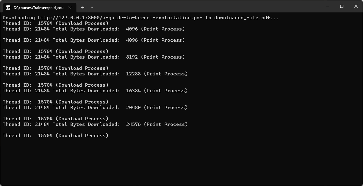

  1. Joseph RW 85 Reputation points
    2025-08-27T11:46:21.2433333+00:00
    I have it working, thanks @RLWA32 , but it seems *SRWLockShared functions failed and only the *SRWLockExclusive worked as intended.
