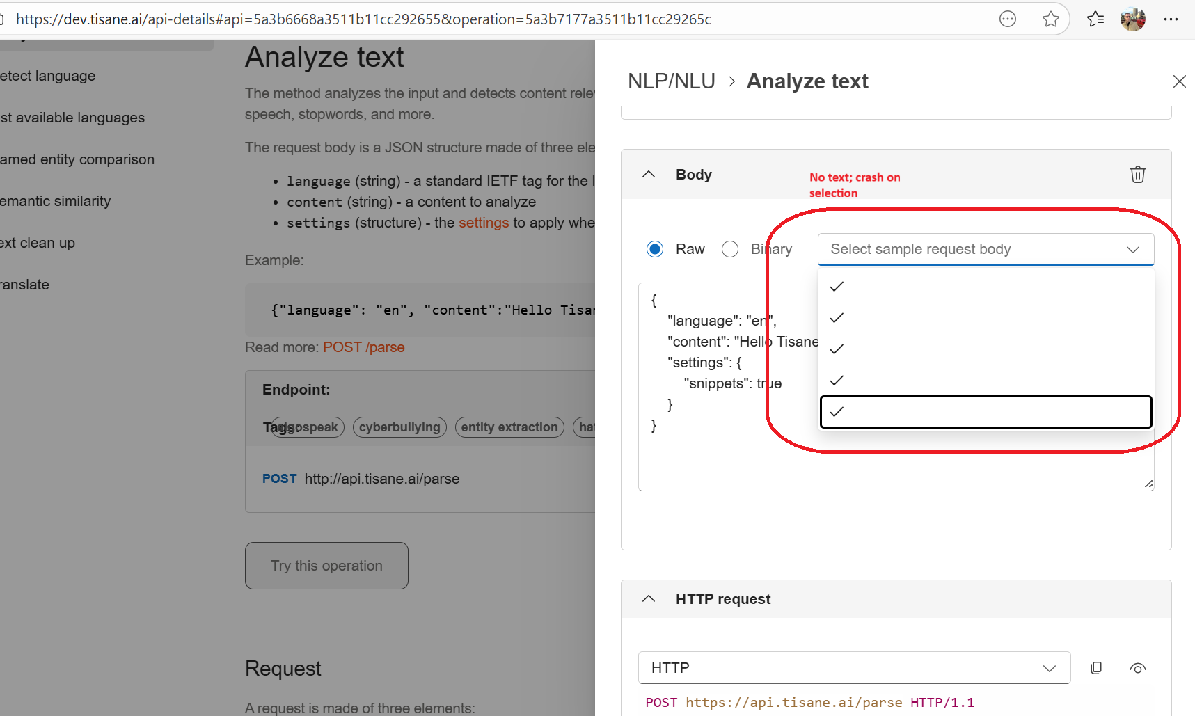

Examples disappeared from the portal, selecting them crashes the UI
After republishing the portal (no changes to the UI, just adding an authentication mechanism), the UI changed drastically.
Now when using Try this operation (previously Try it), the example dropdown only shows checkboxes. When clicking on one of them, the entire dialog closes and much of the text disappears.
See the screenshot below.

I tried most of it before, but just in case, I tried it again. Cleared the cache, removed the cookies. Then republished the portal. Tried in incognito, all the same.
Tried it on 3 different browsers, they all have the same consistent issues after the last update. The browsers I tried are:
Chrome
Edge
VivadiDid you notice any patterns when the UI crashes, such as specific examples or actions that trigger this behavior?
Eh... Yes, I click like I say I did on any example, and that action causes the crash? What else would you like to know?
What I noticed is that in the API definitions in the designer, I no longer see the example descriptions. It's as if the values were deleted after the upgrade.
How long has this issue been occurring since republishing the portal?
Literally as soon as I republished the portal. And it has other UI issues you can see on the screenshot: the tags are out of bounds.
The crash trace is not very helpful, I'm afraid. But it looks like a null reference. It is:
theme.js:2 Click processed
theme.js:2 TypeError: Cannot read properties of undefined (reading 'typeName')
at ConsoleBody (theme.js:2:5790021) at Xh (theme.js:2:1690471) at dj (theme.js:2:1702018) at Wk (theme.js:2:1747784) at Vk (theme.js:2:1736148) at Uk (theme.js:2:1736079) at Jk (theme.js:2:1735948) at Fk (theme.js:2:1733136) at jg (theme.js:2:1674324) at Rk (theme.js:2:1733445)

2025-08-27T10:05:17.86+00:00 It's all public, so you can see these empty dropdown lines and tags out of bounds yourself.

2025-08-28T14:10:56.4633333+00:00 An update.
The issue is happening when Try new UI in the portal is set to true. When I disabled it, things have gotten back to normal.
Azure developers, please fix it.
