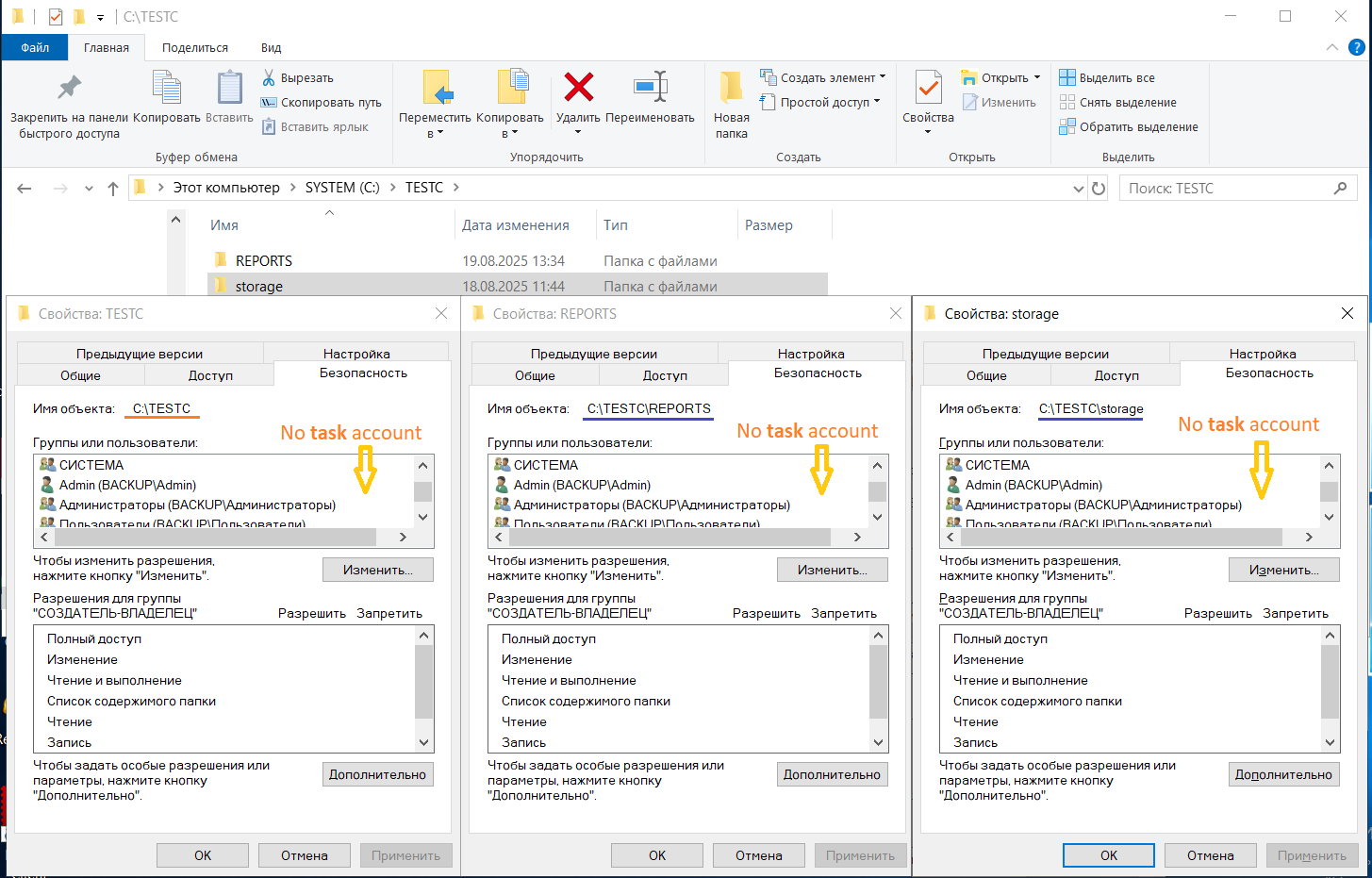

  1. On Server1 I create a test folder C:\TEST with two subfolders - REPORTS and storage

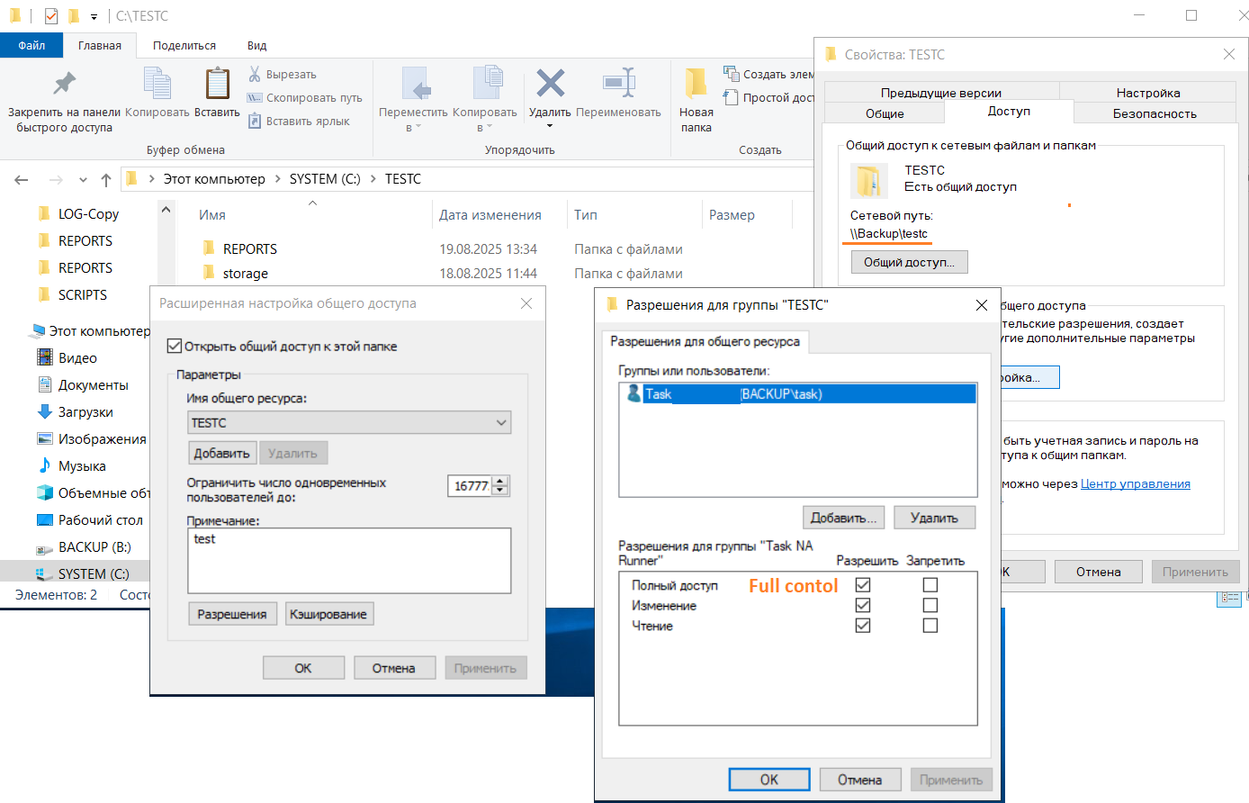

  2. Share C:\TEST using Advanced Sharing for the single local account (Task) - full controll
    01
  3. Do NOT add Task account on the NTFS permissions tab:
    02
  • as a result both subfolders - REPORTS and storage inherit permissions from C:\TESTC WITHOUT permissions for Task account.

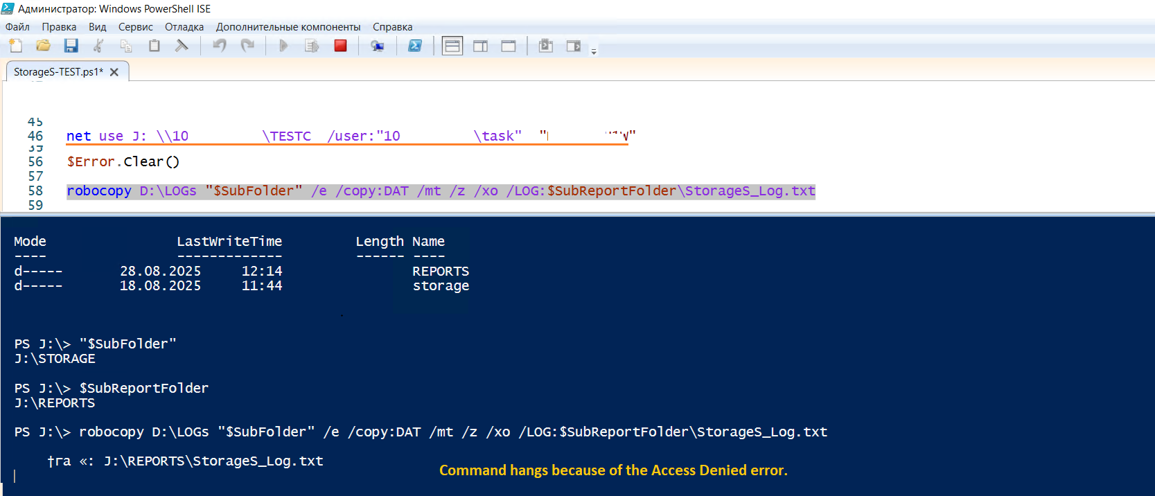

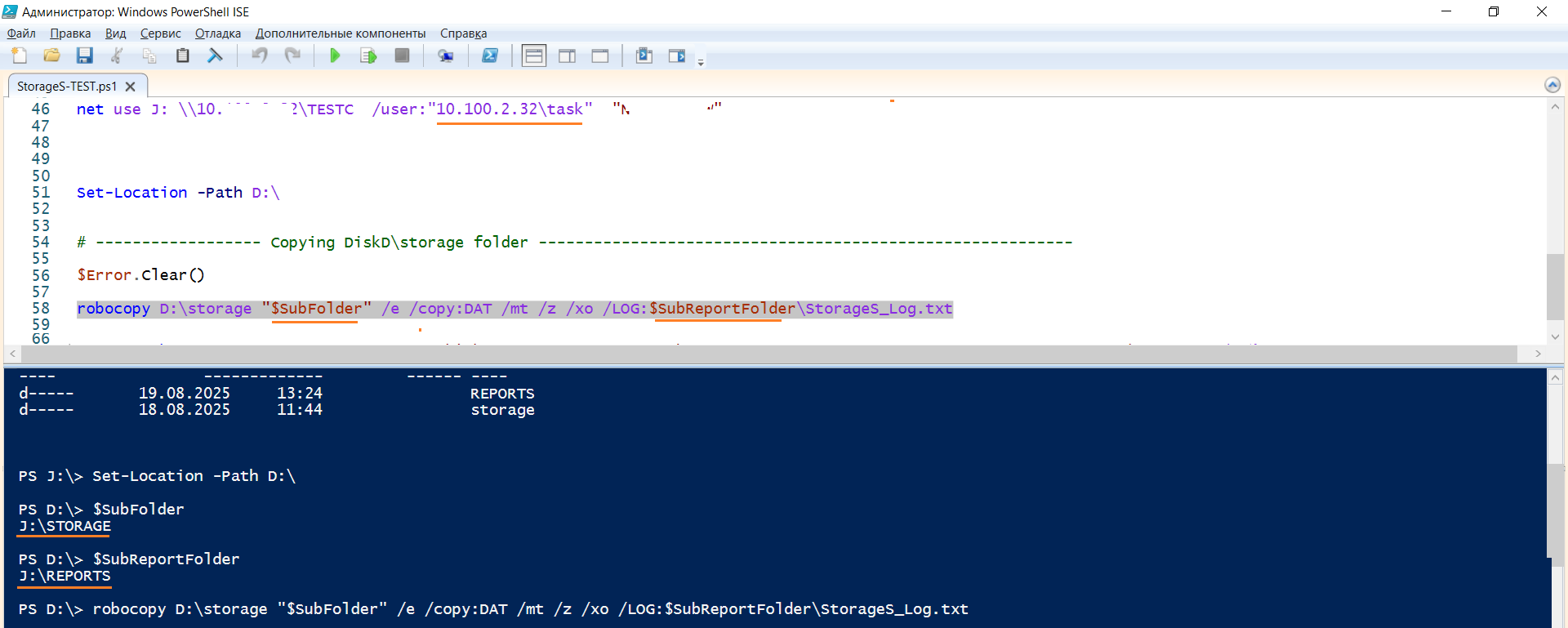

  1. I map the J: to the C:\TASKC under Task account (I can do it because share permission = FC) and try to copy some folder to C:\TASKC\storage (J:\storage) and write the log to C:\TASKC\REPORTS (J:\REPORTS)
    04
Since the Task account does NOT have any write permissions to C:\TESTC (it's neither a member of the Administrators local group nor has been purposely applied write permission on the NTFS tab - it has only read permissions due to its membership in the Users group ) the copy operation should fail in 1) copying to J:\storage in 2) writing the log to J:\REPORTS.

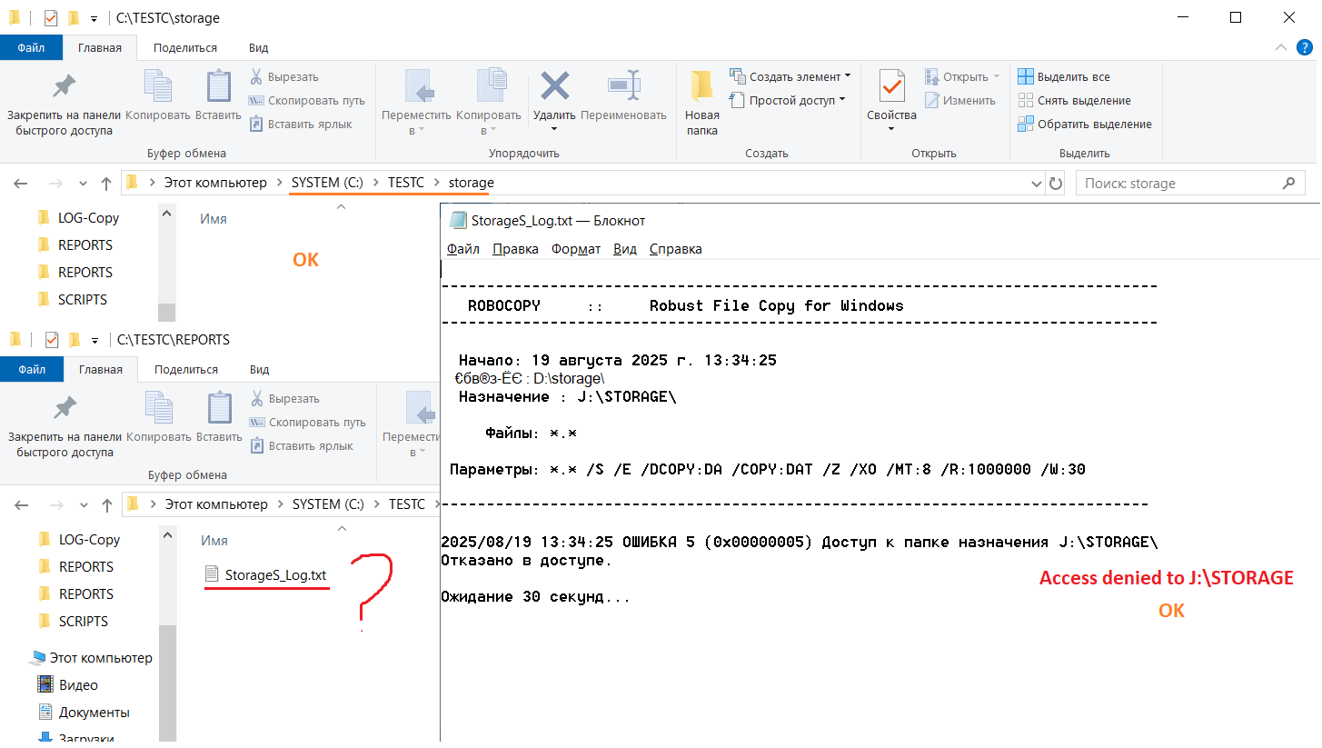

  1. The result: copy operation fails with the Access Denied error as expected but the log is successfully created UNDER the local Task account (I enabled File Access audit and checked it) in the folder that does NOT HAVE WRITE PERMISSION for the Task account:
    Result.1

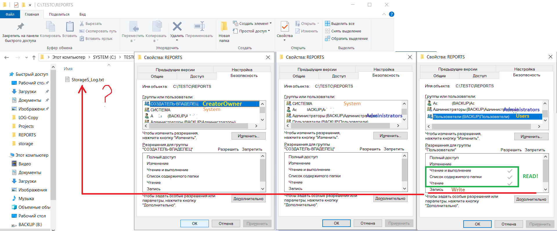

    But the problem is NOT in the absence of permissions for the Task account, the problem is that the Task account is succeeding in writing to the folder (REPORTS) to which it does NOT have write permissions!
    Once again: local Task account does NOT have Write permission to any folders, including C:\TESTC\REPORTS:
    11
    It has only Read and Execute as a member of the local USERS group as depicted above.
    Can anyone tell me how come Task account is able to create the log in C:\TESTC\REPORTS?

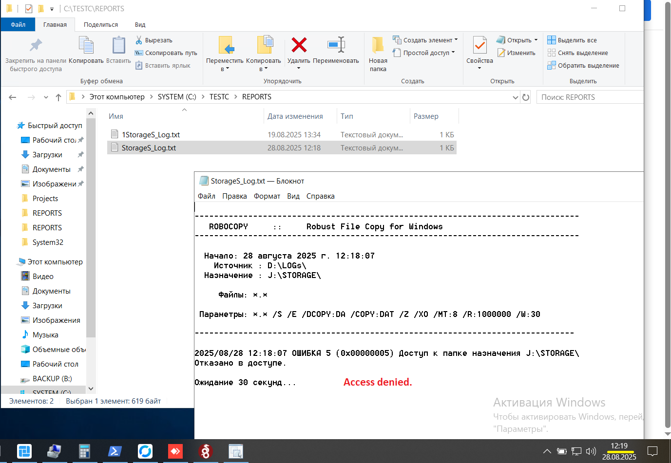

  3. Hram Admin 230 Reputation points
    2025-08-28T09:39:39.4566667+00:00

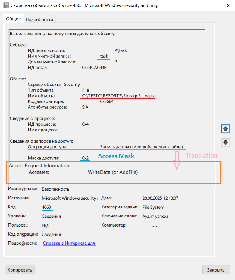

    Here's one more test:
    12-02
    12
    13Event2
    ...Access = WriteData (or AddFile) to the folder with only Read and Execute permission ...
