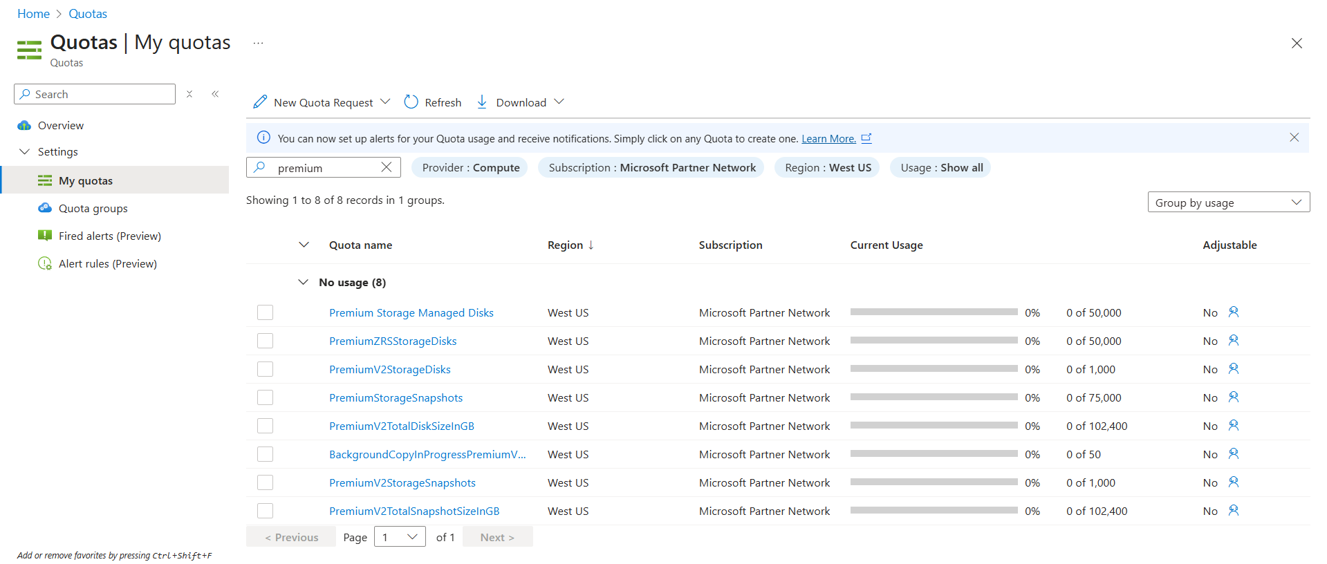

I tried to search in the Quotas section in Azure console but I cannot find anything related to the specific quota that is holding down this deployment.
Screenshot 2025-08-28 094720
Does anyone know which quota I should configure to allow more than one instances on this?

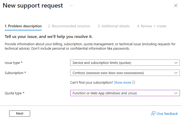

    Hi Kevin,
    Please carefully follow my instructions below to create a new Service and subscription limits (quotas) request to increase your web app quota.
    1. Navigate to this link to start the process:
    https://portal.azure.com/#create/Microsoft.Support
    2. Enter quota in the box and click Go
    3. Select Others / Service and subscription limits (quotas) and click Next
    4. Click Create a support request button, as shown
    5. Select Issue type: Service and subscription limits (quotas), Subscription, Quota type: Function or Web App (Windows and Linux), click Next
    enter image description here
    6. Now you should be on Additional details tab. Click Enter details
    7. Select Region, App Service plan, enter number of App Services VMs requested, then click Save and continue
    8. Finish filling out Additional details tab, click Next, review and click Create. You should receive an automated email within a few minutes.
