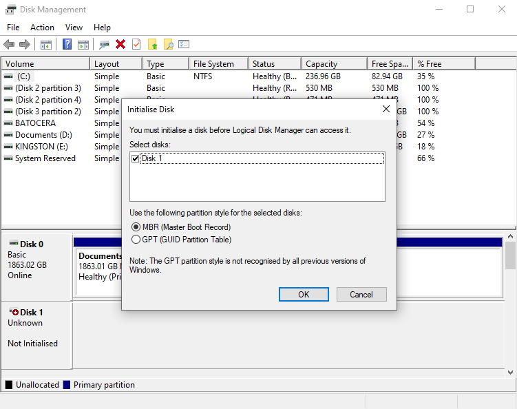

The next time I booted my computer, my 2TB wd2002faex-007ba0 HDD wasn't showing and all the links failed.
It shows in Disk Management but I cannot get it to initialised.

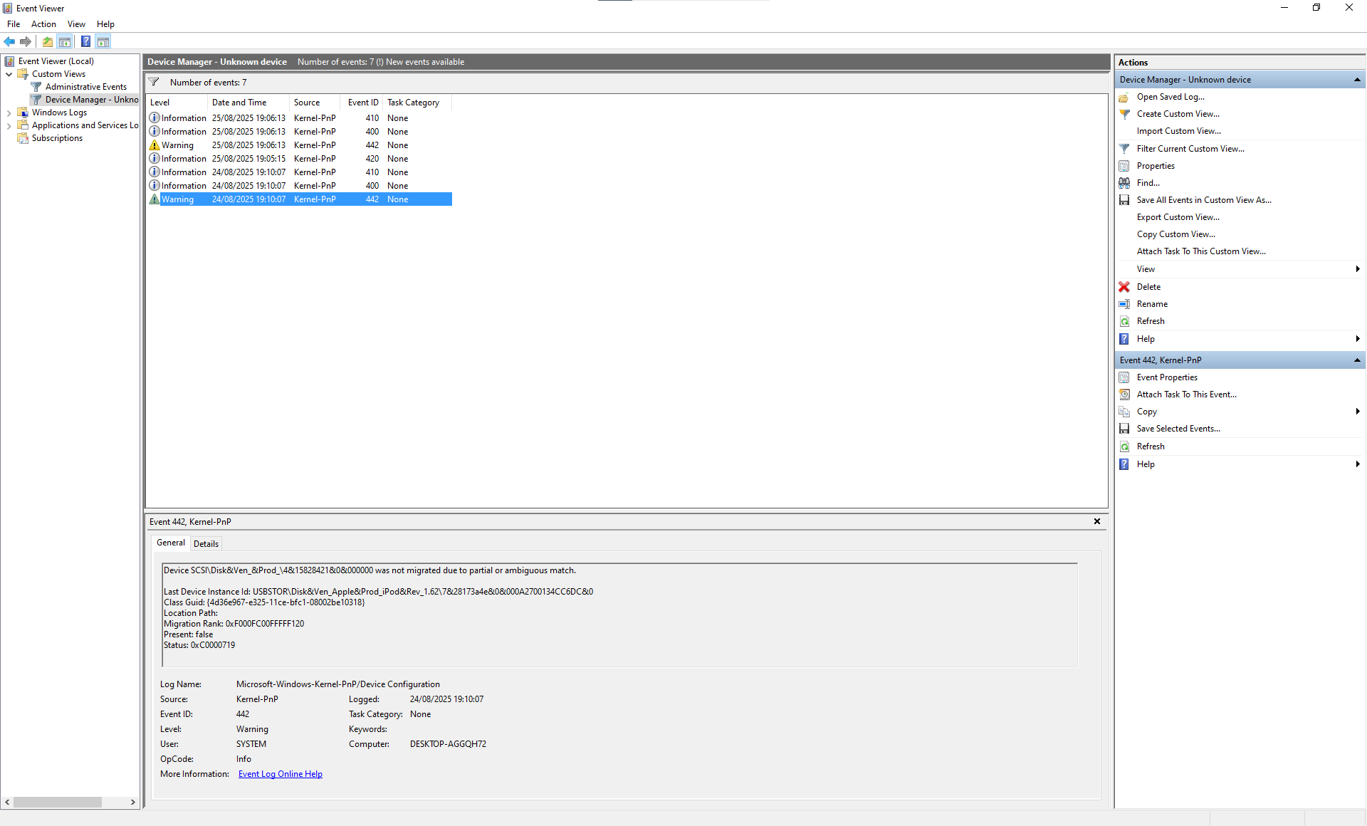

Using CHKDSK doesn’t recognise the drive and it is not showing up in my BIOS.
I was aware of an update causing problems with SSDs but I have the ‘fix’ and it is a HDD, so I did not think I would be effected.

    You're almost certainly dealing with a failing mechanical disk, and the timing with Windows Update is a coincidence. If a drive doesn't appear in firmware/BIOS and won't initialize in Disk Management, no piece of Windows software (including CHKDSK or EaseUS) can bring it back. Those tools only work once the hardware is communicating reliably. The very first priority is to stop trying to initialize or run CHKDSK on it, because that adds wear and can make a marginal disk worse.
    Start by proving whether the problem is the disk or the connection. Power the PC off completely and unplug it. Reseat the SATA data cable and, separately, move the drive to a different SATA power plug from the PSU. If you have a spare known-good SATA cable, use it, and plug the drive into a different motherboard port than before. Now boot straight into the BIOS/UEFI and look at the storage list. If the model "WDC WD2002FAEX-..." and a capacity are shown, the hardware link is alive. If it's still absent after moving both the data cable, power lead, and port, the drive's electronics or mechanics have failed and recovery becomes a job for a professional data-recovery lab. Software cannot help if the firmware cannot see the device.
    If the BIOS does see it, resist the prompt to initialize in Windows, that would overwrite what's left of the partition table. In that case your data is often still recoverable, but the safe path is to take a read-only image of the failing disk to another disk first and work on the copy. I can walk you through that with an open-source workflow (Linux live USB + GNU ddrescue) once you confirm the BIOS detects the drive.
