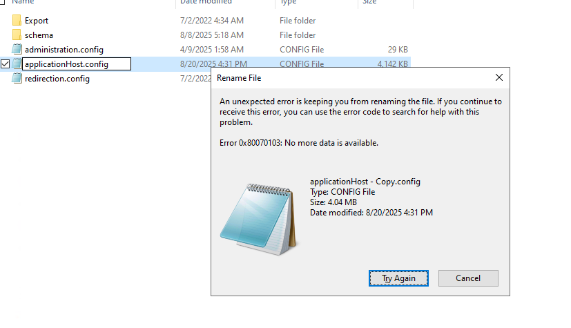

Greetings. I would like to check, regarding from the subject I would like to know why my IIS ApplicationHost.config file is missing out of sudden. I tried many possible ways to restore back however it is not working. Whenever I attempted to restore the file, it gives this error:-
I had tried to restore from C:\inetpub\history\CFGHISTORY_XXXXXXXXXX still can't. I already checked with our Plesk team and they recommended to check with Microsoft team since IIS belongs to them.

    Quick recap: Your applicationHost.config file appears missing, and attempts to restore from C:\inetpub\history\CFGHISTORY_XXXXXXXXXX fail with error 0x80070103 (No more data is available). This is a recoverable issue because IIS relies on this file for site and app pool configuration. Common causes include:

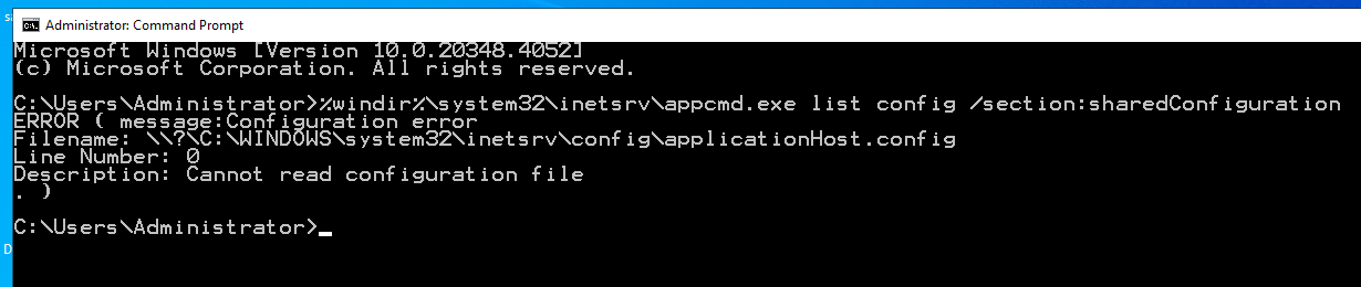

    Good day. Thanks for the revert. I had tried to restore the backup from C:\inetpub\history\ however whenever I am restoring, I am having access denied issue. Like error below:-
    ERROR ( hresult:80070005, message:Command execution failed
    I am wondering why am I getting this and yeah am running everything as administrator.

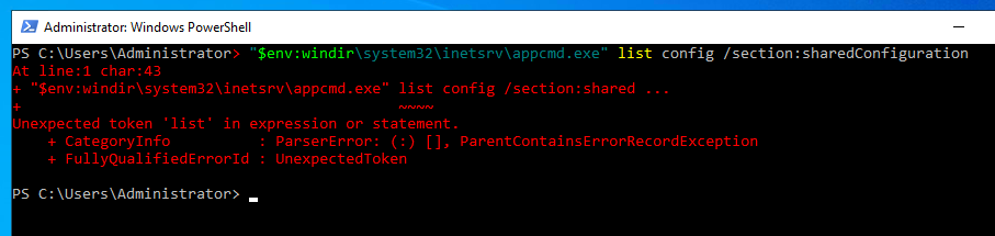

    To add, I am trying to run this command in powershell or cmd getting error like below:-
    Please advise us on this. Thanks.
