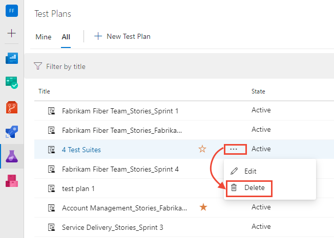

  1. You can also delete a test plan directly from Test Plans. To delete a test plan, open Test Plans and choose More Actions for the plan you want to delete, and choose Delete.
    Screenshot of Test Plans page, delete a test plan.
