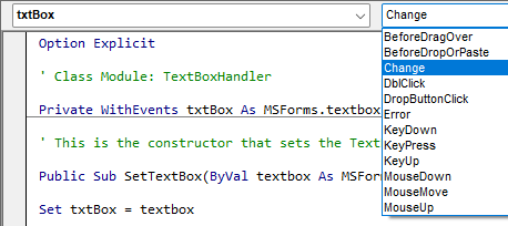

  3. Alex Baja 21 Reputation points
    2025-08-23T00:20:30.7833333+00:00
    I don't think that will work since there is no Exit event available in a class module
