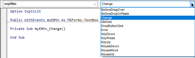

I am having trouble binding a series of textboxe exit events on an excel form to a class module;
Here is My class code:
Public WithEvents myEBtn As MSForms.TextBox
Private Sub myEBtn_end(ByVal Cancel As MSForms.ReturnBoolean)
'MsgBox "hello"
myEBtn.Value = Format(myEBtn.Value, "#,##0")
End Sub
Here is My form initialization code"
Private MyETextBox(1 To 3) As New ExitBtn
Private Sub UserForm_Initialize()
Dim i As Long
Dim ctl As Control
ctl = Me.Controls("txt1")
ctl = Me.Controls("txt" & i)
For i = 1 To 3
Set MyETextBox(i).myEBtn = Me.Controls("txt" & i)
Next i
End Sub
can someone help me?

    I think you meant myEBtn_Exit instead of myEBtn_end. But unfortunately, a custom control does not have an Exit event, nor a BeforeUpdate or AfterUpdate event.
    Perhaps Controling colors of controls in userform will help, although it's quite old.
